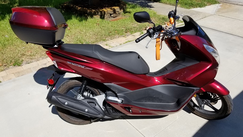

All finished (a few weeks ago, delay in uploading pics). Here it is. I ordered/used the Honda PCX150 mount from my local Honda dealer (apx $42) as I looked and decided what to do as far as a luggage box. After this forum's input, web searches, and talking to my local dealer, Ordered a red SH150I box. Dealer said it won't fit, but the forum said it would so he let me order it in to try with the promise of returning it within 30 days for full refund. No need, as the forum said, it fit perfectly and it looks much better than the std pcx150 black box. It looks like it was made for PCX150 - It is, but Honda won't tell you that. It hasn't been made for almost a decade. It is "new old stock" direct from Honda. I think my date stamp inside the box is 2010, but it is as if it was made today - even the lining. Thanks all for your input and assistance.
FYI, it is 35Liter size and holds a full 3/4 helmet with face visor. Also, it has its own key (I prefer) instead of using the ignition key. Much simpler and easier. Dupes are no problem.
