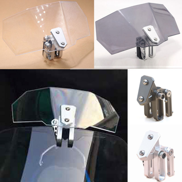

I found a deal on eBay that might appeal to some riders here. It is a clip on wind deflector that goes on the top of your windshield, just in case you still have wind hitting your face. No, I don't have any connection to this website or company. I just thought it would be a good deal for anyone here.
NOTE: THE LOW PRICE (21% off) ENDS TOMORROW ($19.33). However, the normal price is still a steal ($24.55).
Though neither the PCX nor the Forza are on their list of bikes, that does not mean that it won't fit.
Here is the link and a picture.
https://www.ebay.com/itm/Adjustable-Cli ... 2599270592
