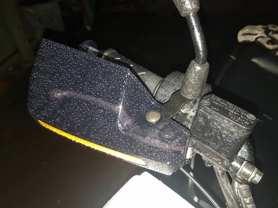

Had this problem, gave up for over a year as any kind of screw bit (philips 3 I think) or mechanical impact driver failed - we even twisted a bit quite badly trying to budge the screws and began to chew them up a little. A few weeks ago I got them off easily by drilling the screw heads off using small to large drills in an electric vari-speed drill - start at 2mm and go up say 3, 5, 6 and maybe 6.5 to get the head off.
No damage to the bar end and the heat from the drilling was enough to loosen the red loctite - never even needed a small blow-torch I bought for the purpose of heating the remaining screw end up! This is the best way and takes 5 minutes each end and the bar end just pops off for easy remaining screw removal. This is a pic of someone else's bike as they just fitted the same bar-end guard I did (£10 delivered off Ebay in smoke, black, red or blue) and stops a lot of the wind chill
Replacement stock bolts (allen key this time!) are M6x45 (40mm thread length and 5mm head) but to fit these you would need M6x55mm bolts.

btw - these can be found by searching Ebay for 'universal hand guards' and stock bolts are csk (countersunk) but to fit these you would need cap head bolts.

Having fitted the cheap hand guard shields as above, and it's been very cold early hours of the morning (- temps with wind chill added) they have proved to be a great addition to the bike. I'm using cheap fleece lined ex-army mitts with vinly glove liners and where before my fingers would still get cold and almost painful, now my fingers feel cool-cold but ok - my chest area feels much colder and I'm sporting t-shirt, fleece, thermal liner and proper bike jacket!
So, good cheap wind protection for about £10 delivered if you do not like bar-end mitt style protection. They also have some reflective strip on them but you could always add you own extra-reflective material to make the front and sides of your bike stand out or even extend the coverage with some soft flexi rubber material to stop more rain.
Note - the pic I posted above was someones elses install of the hand guards (did not have my phone on me at the time) - they fitted the brake lever support bar on top of the little adapter/extender whereas I fitted mine directly between the brake lever and the extender bar. They also added a small extension at the bar end - I did not do that as there is no need - they clear the levers and I can engage full lock with them fitted.
