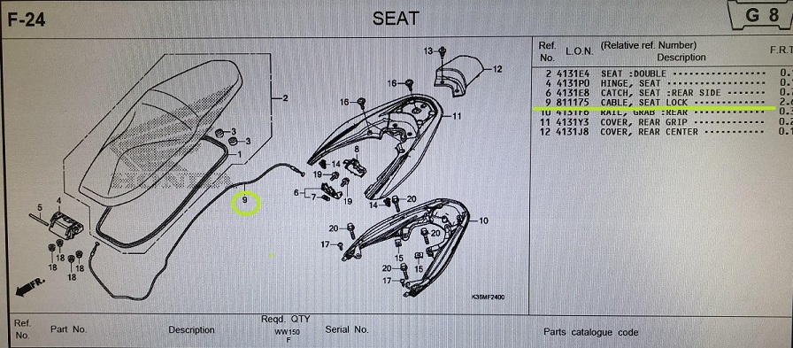

The PCX and Forzas all have a fully mechanical seat and fuel flap release.
Electrical charge makes absolutely no difference, the only thing that matters is the position of the key.

The release catches are operated by bowden cables.
Re: Can't open seat anymore ...
GN is right as usualgn2 wrote:The release catches are operated by bowden cables.
- cable.jpg (178.95 KiB) Viewed 29134 times
