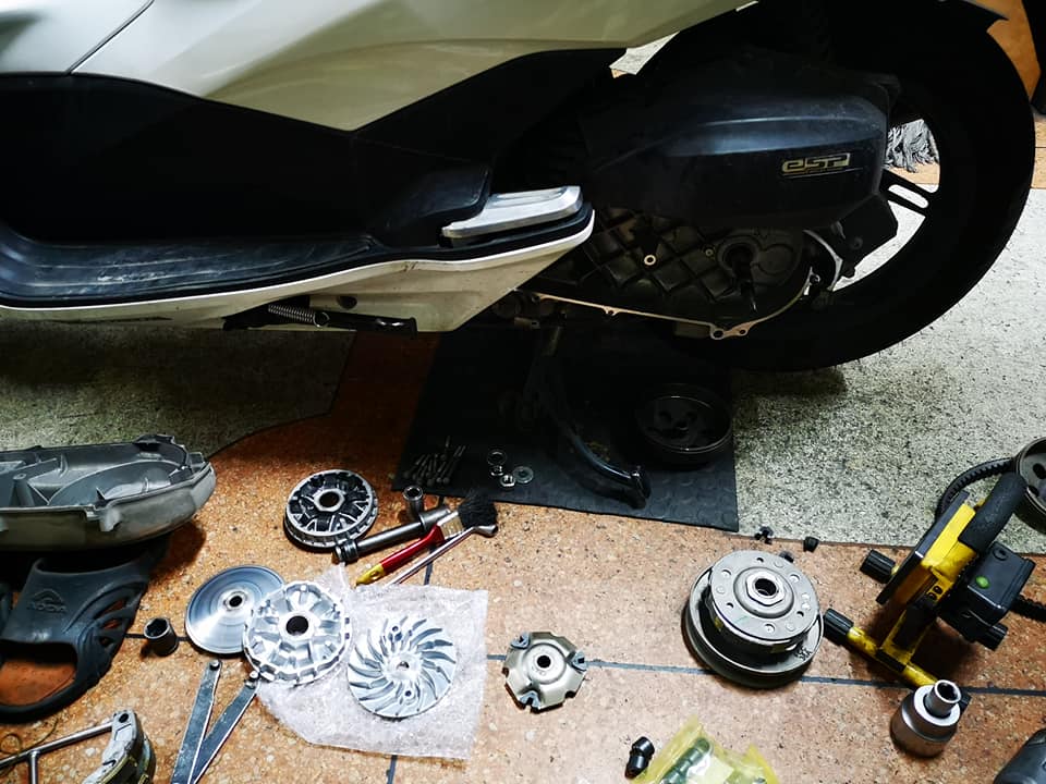

In my search for new pads to solve my noisy clutch problem, I came across a shop that specializes in PCX, nmax, xmax and Forza scooters.
the main guy's quite nice and he knows about the clutch problem of the PCX, said it's pretty common. He then offered his set of variator and clutch for a good price instead of just changing the pads. I'm not sure why, but I agreed instantly. (Guy has some persuasion skills :roll: )
It didn't help that I Saw good reviews on his FB page and he can speak some English. So I booked an appointment tonight at 7 and Here i am thinking if I actually did decide on impulse. My wife thinks i did :D
Review of the mods will follow.
Photos of the clutch pads and variators

Just got back from the shop, took him an hour to change the drive parts.
He said the drive face and clutch pads are already worn, so it's just the perfect time to change.

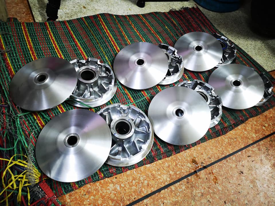

He produce his own drive parts; both plate, drive face, pads and clutch bell.
His version of plate which he claim to add top end and acceleration..

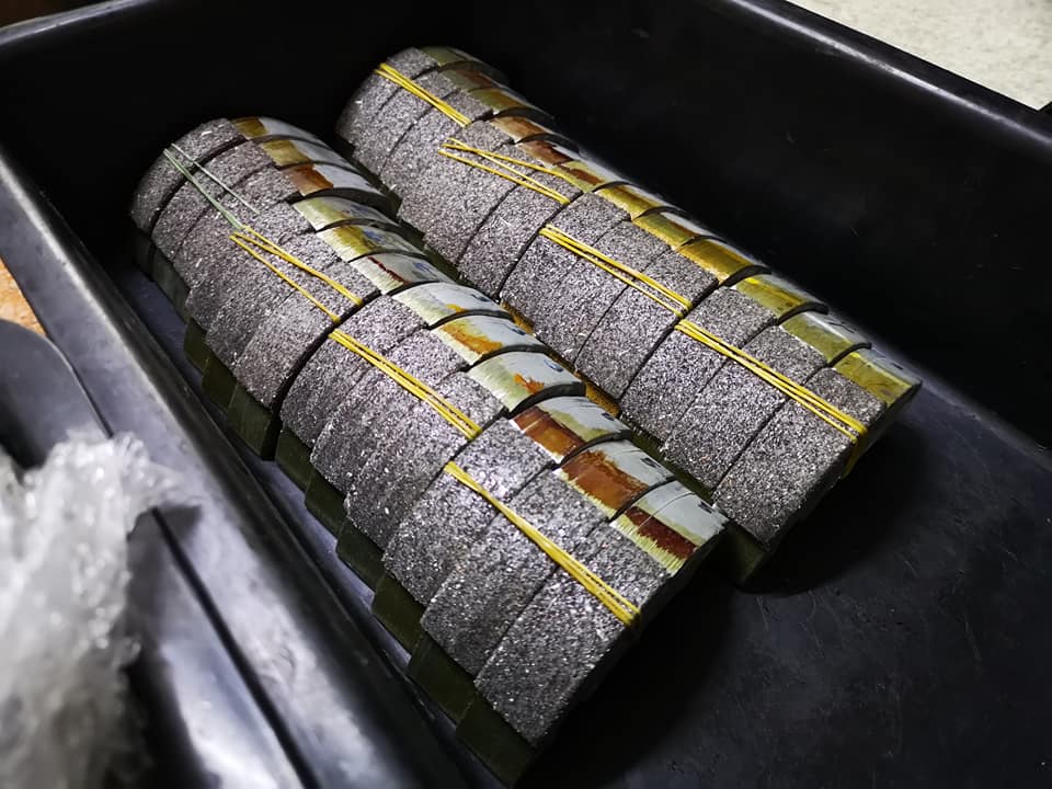

The clutch he said is made of carbon for better grip..

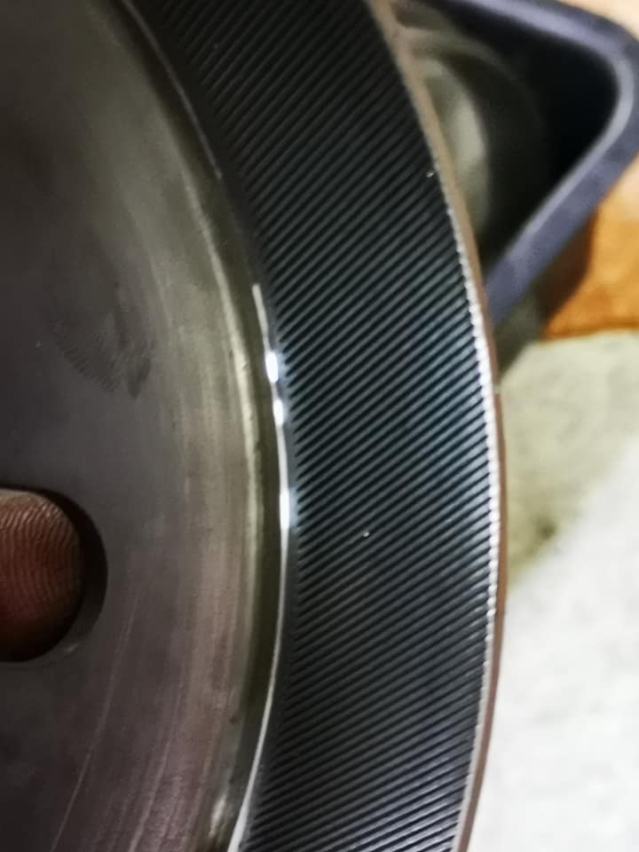

The clutch bell with small grooves on the wall..im guessing for adding grip too

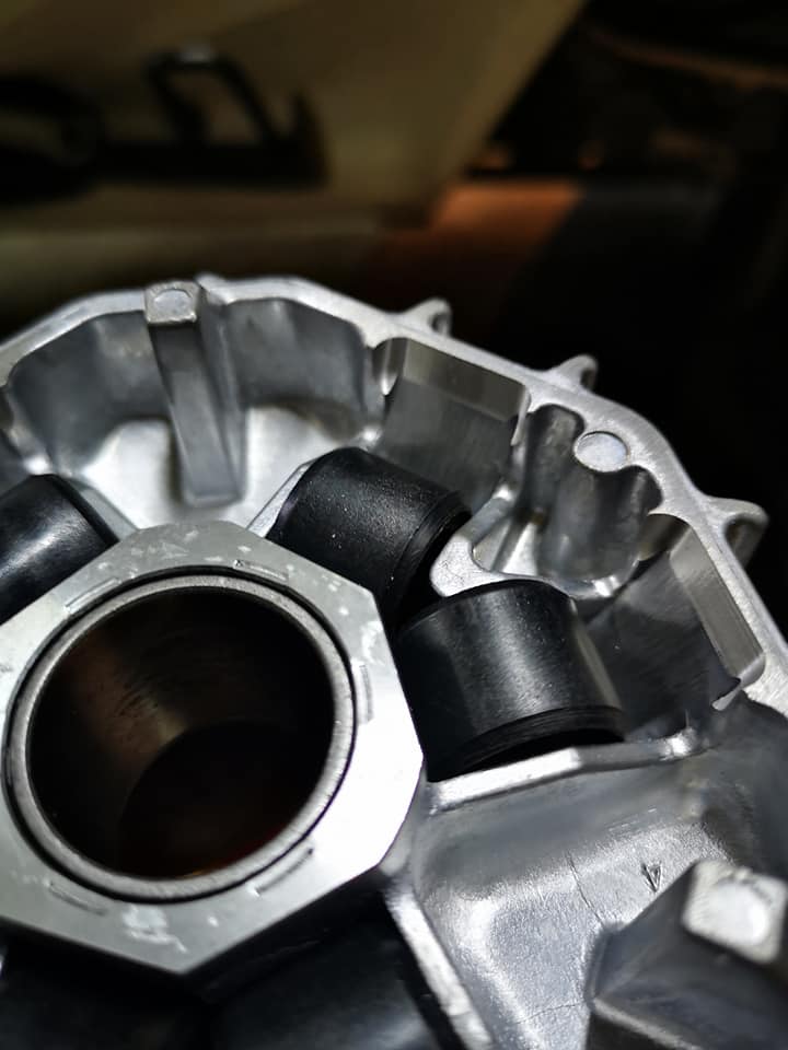

He mixed 11 grams and 13 grams OEM Honda weights (3 each). He said Honda weights are of good quality..

Please correct me if you can concerning this set of unique clutch parts to the best of your ability.
It appears to me from the images of the clutch shoes that a significantly harder material has replaced the softer OEM shoes. This would explain the ability to grove the outer bell race as an aggressive surface on the race would quickly destroy softer standard OEM shoes. If I'm correct in accessing the modification of the clutch shoe materials there WOULD be increased noise :D There also will be increased heat generated by this aggressive aftermarket clutch. Don't misunderstand I'm totally intrigued by the clutch parts you found and I wish I had a set to install but lets get back to the potential problem of excessive heat in the area of the clutch and bell housing.
Adjacent and right next to your clutch is a very delicate balance of grease and bearings, the ones that make up the FACE SET DRIVEN. The FSD bearings are notoriously sensitive for lacking grease and failing. The quality, consistency, amount and heat tolerances of the grease used is critical on these bearings. If the grease melts you'll lose it and grease will run into the race area of the clutch bell. The grooved area of the clutch bell is where you'll need to monitor while you test this new design in summer months. If you find grease in the clutch race strip out all existing grease from the bearings and repack according to the manual (specifically 7 grams of grease) no more, no less with a higher heat tolerance grease. Clean up the shoes and race by cooking off any old grease with a hot air gun and try again with high quality upgraded grease.
I'm very interested in this agressive clutch design, its longevity, performance and how it manages heat around the bearings will be fun. I hope I haven't disturbed you. The worse than could happen is you'll need a new FSDriven pulley assembly sooner rather than later if the heat transfers to the bearings and you don't notice whats happening. Symptoms will be changes in the clutch performance and sound as grease enters the race area. Perhaps smoke and smell but no damages to your clutch just burning grease from the FSD bearings. Keep us posted please and its fun to tinker with the variator and clutch for sure... ENJOY!

it actually crossed my mind, the hardened material will surely generate more heat. I am imagining fireworks inside my clutch bell as the hard material grind the grooved wall. :?

No fireworks if he's found the proper hardness of shoes. Note the angle of the grooves on the race are forgiving AND self cleansing :o you'll never have problems with glazing :lol:
When I was a kid we had the standard mini bike centrifugal clutch and it was pretty much steel on steel. Indestructible and never needed replacement parts it was the C-clip that held the outer bell chain sprocket that wore thin and broke before anything else. The outer bell and chain would fall off and the steel shoes would come off like a grenade o_O I still have a scar on my chin from one of the steel shoes hitting me in the chin :lol: Do you remember these little time bombs? They were GREAT!
I'm really liking this guys design a lot! Enough to sort out any heat transfer to bearings with high temp grease.
