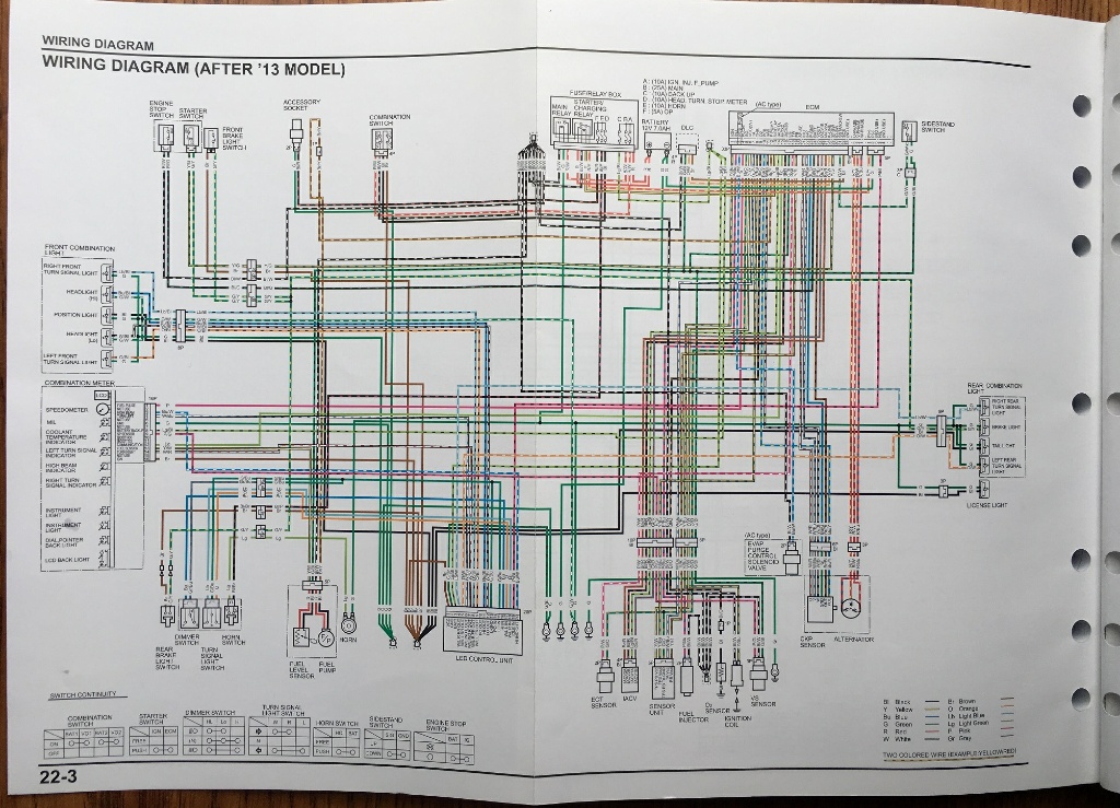

Homie,
I found this among the many files I have collected from this forum over the years. I hope it helps you.

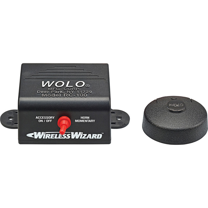

I might be way off base with this Wireless idea but here goes...how about something like this?
https://www.northerntool.com/shop/tools ... 0301008005
I am not an electrician, but I dabble. Maybe it'll stir up thought?
If so...Bring it On Hooligan's!

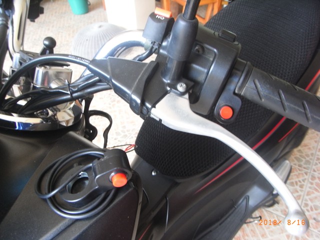

Hello Brando you can this from aliexpress it works very good and easy to reach but it is not waterproof so I put in same vaseline https://www.aliexpress.com/item/ATV-Hor ... 4c4dJYD0A1
