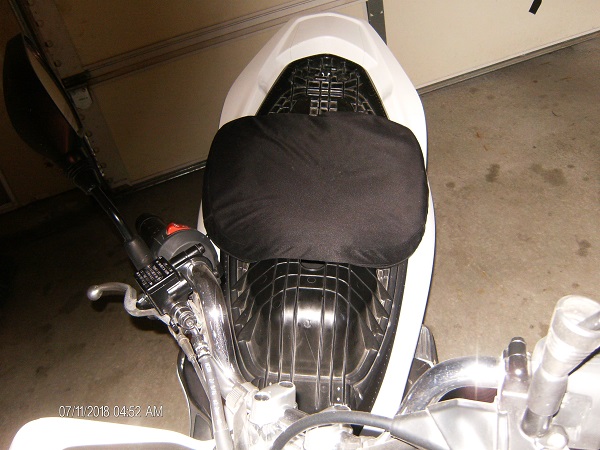

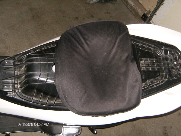

I have been enjoying my scooter since I have taken off the seat cover, and removed the foam. Doing so has expanded my saddle area. I sit on an "egg sitter" cushion, which is a gel pad. While this has improved my enjoyment, I still wish I could get that plastic hump off my tray. It bumps up against my tail bone, and is very annoying. Structurally, I cannot simply cut it out. Does anyone have ideas of what type of craftsman might be able to rework the plastic tray so that the hump is removed? I don't think an upholstery shop would be a good choice because mainly they work with foam and covers. I want the whole area above where I sit to be smoothed out.

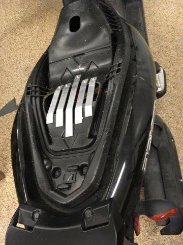

Like this.
1 inch aluminum flat bar and some pop rivets.

That's really helpful to see what it looks like to have that hump removed. I was worried that cutting it out might severely weaken the integrity of the seat. It doesn't appear that it would, judging by your image, even without the aluminum bars or pop rivets. I would like to ask you a question. Where do I get aluminum flat bars, and do I need a special tool to use pop rivets? I do not know what pop rivets are. The only thing that comes to mind is those rivets that some people put on their clothing, such as jean jackets, etc.NADman wrote:Like this.

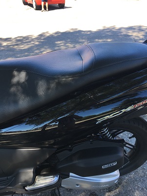

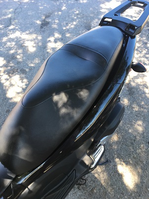

Re: Reworking plastic seat tray?
Even with doing some of the 'dirty work' myself it still took a Pro 2-3 hrs. to come up with my finished
and extremely comfortable seat.
You say "$200 bucks"???
I say "Priceless."
I don't know them but try: http://www.andrewsupholsteryidaho.com/
I say "Priceless."
