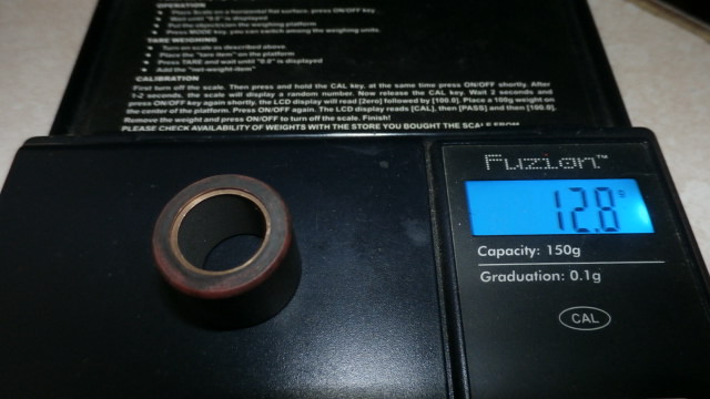

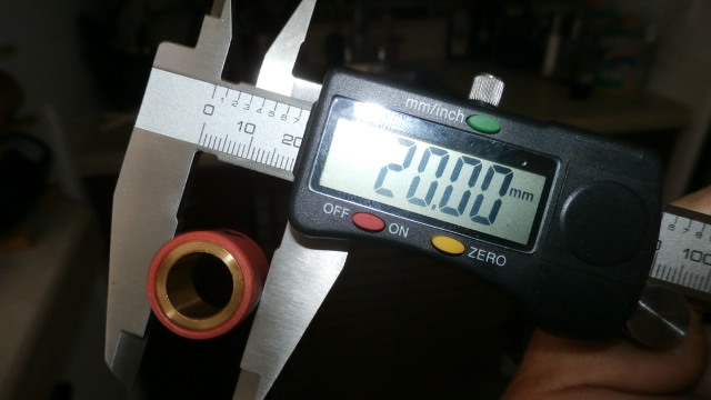

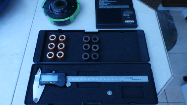

I was thinking of adding this to an existing topic but really it deserves one of it's own. For those that aren't following the other related threads this is testament not only to the quality and durability of the NCY rollers, but also to the machining of their variator. These rollers were removed after 10k of use, mostly commuting but around 15% at speeds of 45-55mph as well. So to continue, old and new rollers were measured with a digital scale down to 1/10 of a gram, and measured with a digital caliper down to 1/10th of a mm, I considered using thousandths and grains but to keep things simple and conversion free I settled for the understandable for the non technical folks here. If interested proceed on...

Re: NCY Roller weights, quality and durability. 10K test
1st the Rollers, no flat spots were evident. heres the old (10k) vs the new. As can be seen very little wear is evident. How much of this is due to the rollers themselves or the Teflon coating in the NCY variator is unknown. The Teflon coating along the roller paths is now worn through, but for how long I cannot surmise.

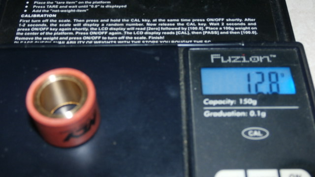

Weighing the rollers, again old vs new.

Draw your own conclusions, but from what I see you ought to be good for 10k using NCY Variator/roller combo. The belt also lasted for 10k. Over that time acceleration remained pretty much the same but the top end dropped off after about 5-6k, seeing what I see here you'd be better off changing the belt about twice as often as your NCY rollers to maintain optimum performance. And even if you choose to wait and replace both at 10k the performance hit is hardly game changing with the possible exception of the top end. A max recorded 72mph when all was new, to 64mph after 10k. So again after seeing the evidence the belt stretching/wear is evidently more of a factor at least with the PCX 150.
