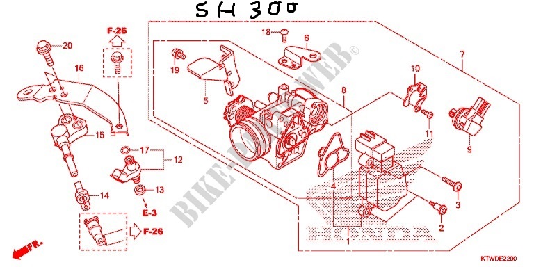

Hello
I am a new member
I have a pcx 125 V1 {2010} with full set yuminashi 164cc for 2 years and I am very pleased.
I have to ask, I think to put pcx150 head and forza 35mm TB, to proceed? what will I win, will I have a problem?
I have a 35mm throttle body from SH 300 I think is the same with forza 35mm TB ,thank you and sorry for my English, it's from translation

Pcxdemon
Posts: 932
Re: ECU tuning pgm fi controller yuminashi
Post by Pcxdemon »
I use forza 35mm TB and Chameleon intake manifold from webike, it's match made in heaven. 150 head upgrade on 125 model is a must with bbk. That'll solve your overheating issue. I use 169 takegawa cylinder with split gasket for higher comp, yuminashi cam, takegawa fi con fuel controller from 125 model with yuminashi 6 hole injector, takegawa exhaust, mfr2 vario (modded) with Dr pulley weights and I've got so much power/torque it's insane... 300's can't touch me.
