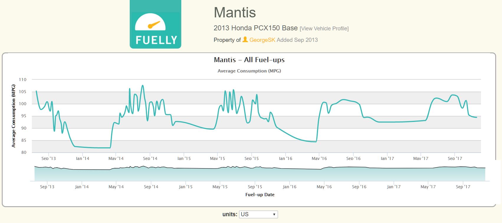

You don't really need to run it dry. Fill it up, set the trip ODO to zero. Ride for 100 miles or so and fill up again. Divide your miles by the gallons required to fill it back up, and you got it. Do it a half dozen times and you have a pretty good number.
For more fun you can track it at fuelly.com
- Mantis Milage.JPG (105.44 KiB) Viewed 2619 times
