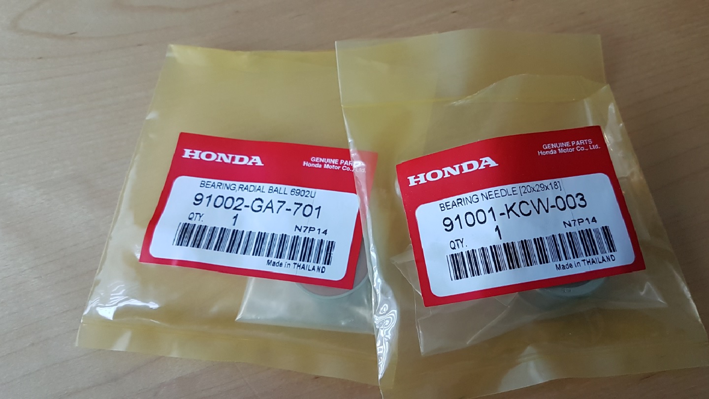

Yep, thanks. I have all the genuine Honda parts from my local dealer.
belt / rollers / slide pieces (a.k.a. dampers) / two new bearings (1 for clutch assembly sand one for left side cover just in case).

small update, new bearings are here :D , I just have to find some time to install them. At the end I chose the NTN bearings and I will replace them myself.

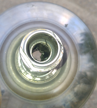

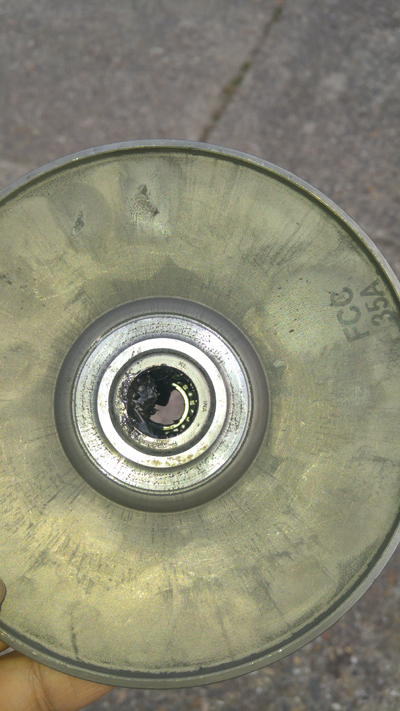

Asked my mech to replace the driven face assembly since i had the replacement spare handy (Had quite a bit of noise from transmission) .Guy left me the old parts so i inspected them. The old driven face from late december 2014 (led) had actually quite a lot of black grease left in it- Much more than 7 grams. He did the belt as well ( PCX is 21.000 Km) . It's much smoother and silent now but i am wondering if the belt change is not responsible for it too. So I really thought maybe i changed the driven face for nothing- Ok i did not try to turn the bearing in the old driven face yet- too packed with filthy grease and no time for it yet. I'll report later.
For now , gone is the damn metallic rasp noise and enjoying a nice difference in accelaration, even with nothing broken in... So heads up, if yours is close to 20,000 Km maybe the belt is also needing attention...

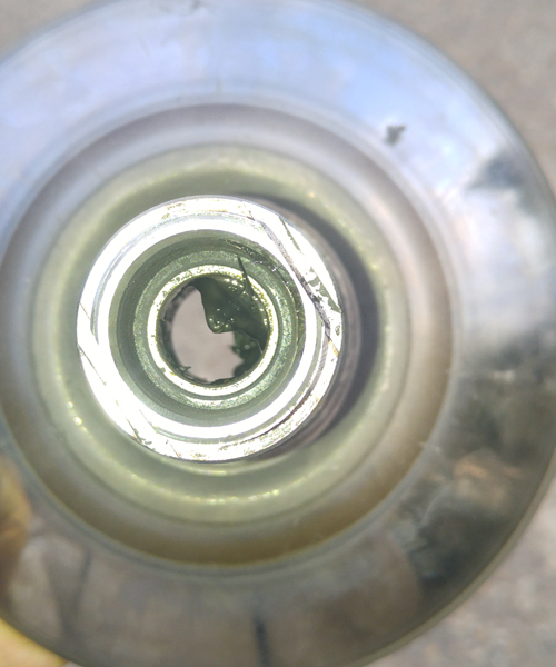

In the top photo, it sounds to me like rollers are rattling away, Should not be any grease on the outside face(s) where belt rides.
Re: Strange sound from the vario
First of all let me say that any time you change the belt your acceleration will improve.
Next, you can bet that the problem and noise you heard were from that clutch bearing. Even with a lot of grease on the outside, the inner bearing can still be bad. There are two bearings in that assembly, either one of which could have had the problem. Just because there is a lot of grease on the outside, it does not mean that there was enough on the inside. Our bearing problem started at 10k miles, so 12k miles is within the "going bad" time frame.
Enjoy your repaired ride and don't worry about whether you fixed it for no apparent reason. You did the right thing.

Post by tomtomclub2005 »
You are right Mel, i can definitely say the bearings in the driven were out, it's a lot more silent now, very easy to notice when freewheeling engine off. I have heard lots of comments saying failure was due because there was not enough grease from start, well my late December 2014 LED PCX had plenty still packed in just see pics.
