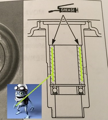

@ amin12345
7 ounces of the service manual's specified grease packed into a bone dry (face set driven clutch) between the bearings (no more, no less) or you might experience shudder as the grease (if not quality OR too much) can melt down into the clutch outer bells inner race. Contaminating the clutch shoes with oily residue will result in shudder and sanding of the shoes alone will only give temporary relief from the juttery acceleration. You must take a contaminated clutch shoe one step further by heating the pads with a hot air gun to smoking temperatures burning the oily residue out of the shoes OR replace the clutch shoes entirely to completely escape this relatively harmless but irritating shudder.
On the other hand if too little grease is packed you may get what many have seen in the past where one or both of the bearings inside the assembly fail and a grinding sound from the rear wheel becomes the topic of discussion. I learned this the hard way but did save my rather expensive stock clutch by heating the old grease out of the bearing area and carefully repacking with proper (quantity and quality grease) per the service manual to get this most delicate and sensitive balance of mechanical genus to work properly.
Thanks Homie, I haven't replaced or touched the grease since I brought this Pcx and since I cleaned the clutch I am almost to 500 miles and no shutter as of yet.
