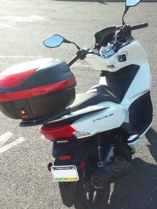

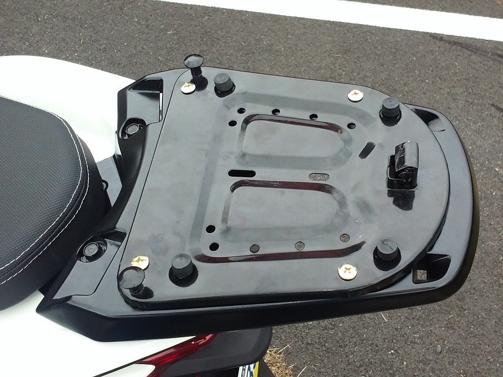

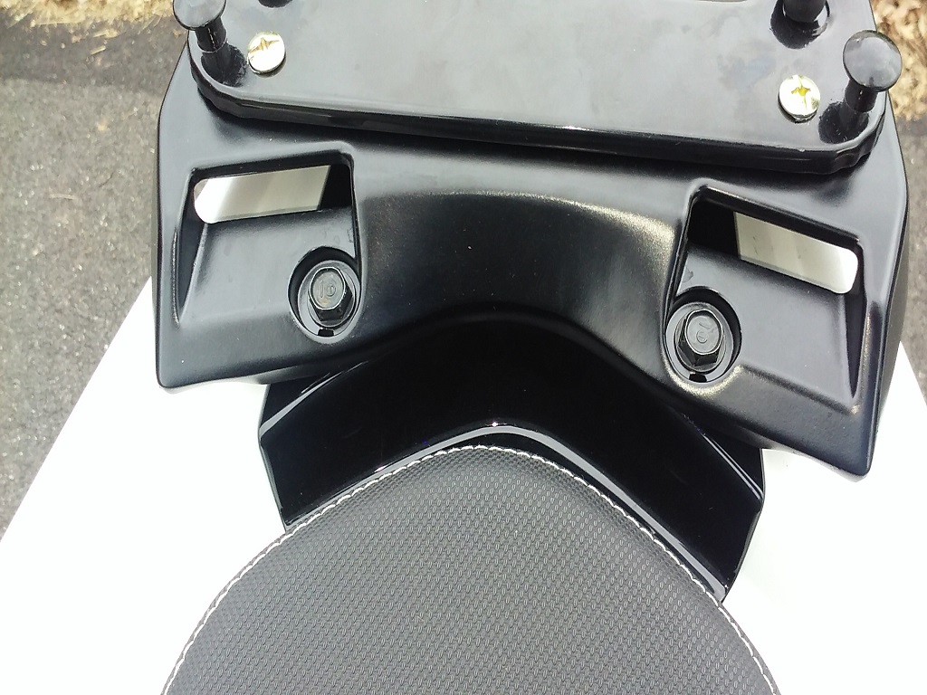

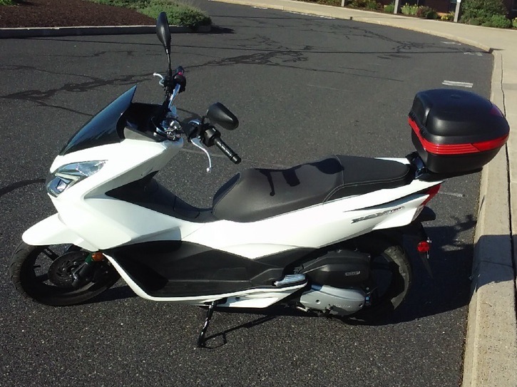

I added a Honda 08L71-K35-J01 rear trunk attachment kit and a MMG 997 top box. I drilled matching holes in the cover that hides the mounting holes, but destroyed the cover in the process. I thought I ordered a replacement cover in white, but I ordered a black one instead. This one I didn't wreck, and it looks great. I had to drill 4 holes in the Honda bracket and 4 in the MMG mounting plate, since nothing matched. I should have taken pictures along the way, but I was too excited. Here are a couple pictures after I finished.

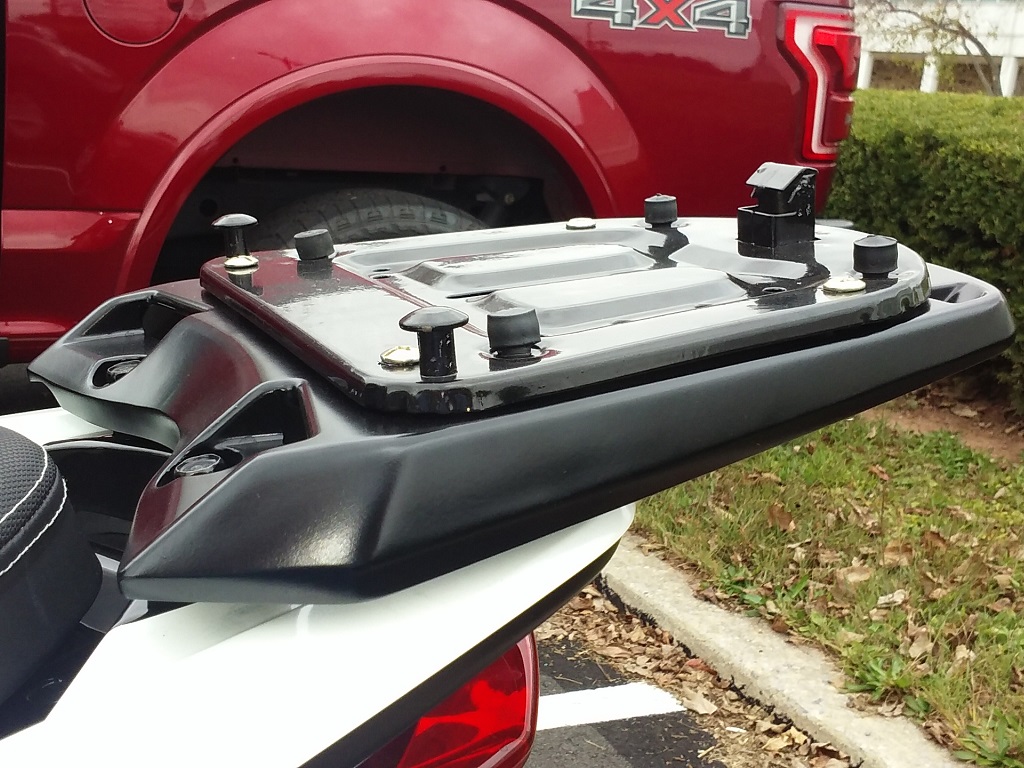

A bunch more pictures.

I have a similar mounting plate and top box on a bike in Thailand (not my PCX). You will find that the metal hook and latch will start to loosen up and the box will rattle.
I tried using some foam rubber to make small donuts around the metal hook. That worked for a while.
I eventually ran a couple bolts from under the mounting plate, put nuts on the top of the plate, then washers and wing nuts inside the box. Much more solid.
