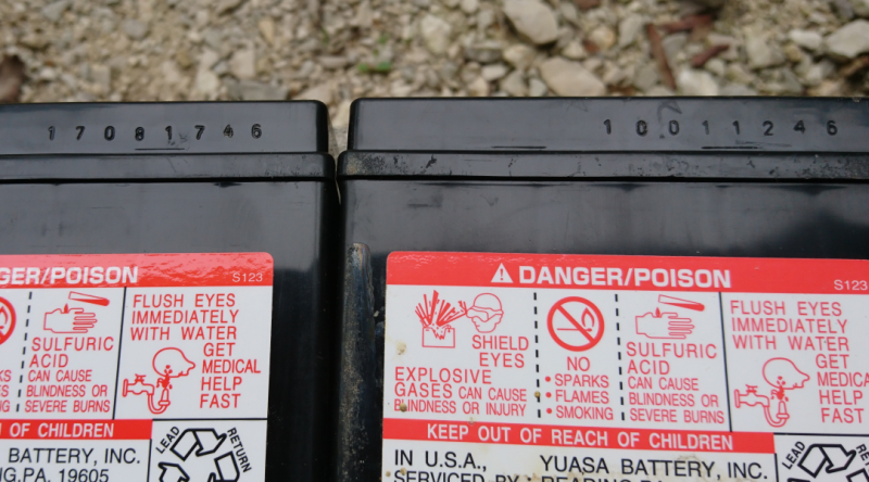

After nearly 6 years and 16,000 miles the battery has been replaced. Since the yuasa lasted so long i decided to replace it with another one. The old one still seemed to start the engine just fine, however; a couple weeks ago i pulled over for a minute and shut the engine off using the sidestand so the key and lights were still on. Then when i tried to start it nothing happened. I shut the key off for a minute and then it started fine.
Can anyone confirm these numbers stamped on the battery is the date code? My guess is the format is DDMMYY46. So the new battery on the left was made August 2017 and the old one January 2012.
