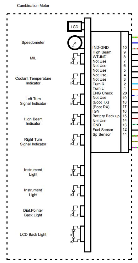

I did a bit of Googling for you - and looked up the manual - nothing of significance found I'm afraid.
From the manual we can see that they're LEDs, but no further breakdown.
- 1.JPG (57.47 KiB) Viewed 5622 times

Thanks Maverick for the schematic/wiring colour code pin-out.
Like you say, at least we know they actually use LED's now in the speedo console as opposed to normal dash bulbs. Just don't know what type, size, manufacturer details etc.
Main "backlight" showing 2 led's connected in series, that's why there is total darkness. Instead of just losing some light, when either single led has fused, you lose the lot!
My theory so far, is that I have an LED fused and a separate bad connection, fuel gauge issue. Probably on the board or with the fuel gauge itself. Notice the fuel gauge is not actually represented on that schematic, unless it's the LCD (at the top). Could be a totally separate unit in the console.
Cheers!
Cheers!

Good luck - in terms of parts, the complete speedo is probably the next highest assembly.Perce2 wrote:Thanks Maverick for the schematic/wiring colour code pin-out.
Cheers!
Let us know how you get on.

Best I can tell, the power for the lights is drawn off the common power for the rest of the panel - so something external like the connector couldn't cause only a couple of the lights to flicker - so I'd think it's more likely to be inner circuit board.iceman wrote:It's more likely a connection issue as stated, perhaps poor soldering on the inner circuit board, but mostly likely if not a multi way connector issue, some bad wiring from ECU/Battery to console - could be a poor earth connection or such. The circuit diagrams can be found searching this forum or google, so best grab them all.

I agree with Maverick, power is obviously reaching the circuit board as the other LED's are working fine, ruling out connector theory. I have also had the top off and cleaned and checked all plug terminations, they are fine. The problem appears to be in the speedo assembly itself where we are lacking information so far.
