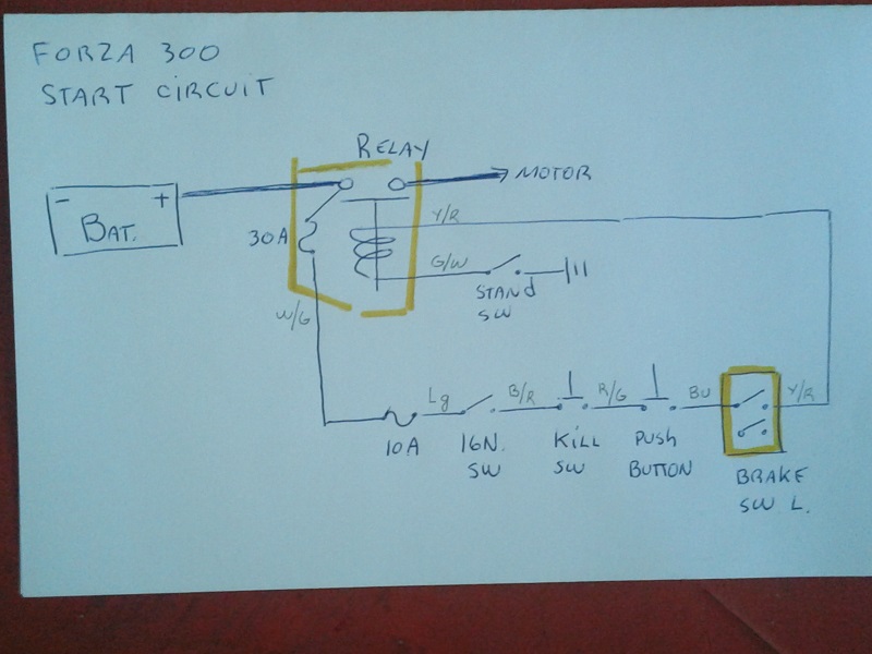

Here's a copy of the Forza's Starting Syst. Diagram, made as simple as possible.Cactus wrote:I was looking at the Online Parts Fiche, I see the rear brake switch, try again in a few days.
Current flows from the Battery...to the Relay, passing through all shown switches and fuses.
As easy as that.
On mine, I bypassed the f...ing brake/inhibitor switch, using a 5A mini fuse. That switch
needs an arm and a leg to budge, plus it is totally useless.
