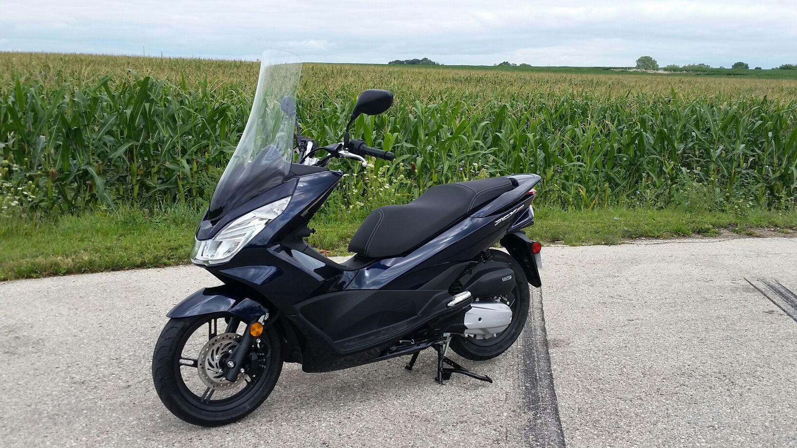

Just got a 2017 blue PCX 150 and so far after 100 miles I love it, but I have some questions.
1. On 2017 PCX150 is the left brake lever controlling both front and rear brakes? Owner's Manual keeps referring to left brake lever as the rear brake but in other places I've seen it referenced as a combination lever.
2. Is there a way to make the parking brake work? I made sure rear brake was adjusted exactly as Manual says and parking brake still does nothing.
3. Rear shocks are poor and I see there are good aftermarket choices. Has anyone just cut a couple 1" diameter holes in the inner box liner under the seat to access the top shock mount, or is it really necessary to tear half the body work off to do this?
4. Is the 2017 manufactured in Vietnam or Japan? I've seen both mentioned.
Many thanks - looking forward to lots of fun with this baby!!!

heydave, Welcome to the board!
The right lever (where your reservoir is) will slip the front wheel first on gravel before the rear even though it's combi... treat it like the front brake it mostly is. The left will slip the rear wheel first but you always pull them evenly together for optimal braking.
To set the brake lock put on the center stand;
1. Squeeze the left hand brake hard several times without touching the brake lock knob and release the lever.
2. Go to the nut at the rear axle and rotate it clockwise one increment at a time until the wheel has resistance enough it will not spin more than a few inches with a good thrust.
3. Check now that you will not be able to set the brake lock at all... because there is not enough play.
4. Turn the nut one increment at a time counterclockwise until you can set the brake lock. Check each time you meet a new increment on the nut if you can set the brake lock and stop when you can.
When you can set the brake lock you will have free spin on the wheel, the shoes will be properly adjusted and the brake lock will work as good as the stupid thing can.
IMO and personal experience never use the brake lock for more than adjusting your drum shoes because if you fail to release it someday you burn up the shoes. No indicator, no idiot light and you can't feel it's on when driving... just smell burt shoe when get to destination.
No one has cut a hole in the luggage box yet to make rear shock access easier, just me talking about it on a YT video
Made in Vietnam or Japan?.... its says on the colum to the left of the ignition.

heydave17 ...welcome to the PCX forum, nice looking scooter
I never used my park brake as I figure the double kick stand will keep it stable and is more reliable, and as homie says it's easy to forget to release the parking brake
Mel46....my guess is he's from Iowa with all that corn in the background

Here's a link that describes the Combined Braking System from Honda.
http://world.honda.com/PCX/chassis/page02.html
If your PCX is a 2017 it's from Vietnam. Mine is also. Great workmanship and nicely put together.

I'm in central Wisconsin - lots of corn here too! I will fix my profile - thanks for the tip.
So I can confirm it was made in Vietnam according to the manufacturer's label. The right hand brake (hydraulic) controls only the front brake as verified on the center stand. I adjusted the rear brake per your instruction and now the parking brake works but I absolutely see myself leaving it on and frying the rear pads so probably won't use it. I have had Harley Davidson's in the past and I always kept a short nylon strap with Velcro on it to hold the front brake lever down if I felt I needed a parking brake and that is probably what I will do with this one - no chance of riding away with that still on! I'm going to carefully look at the shock mount idea before hacking anything up. There are a lot of plastic plugs that would snap right in as long as it is a perfectly round hole. I'm seeing a lot of good tips on shocks in this forum. Oh, and my windshield is called a Medium height - can't imagine how tall the Tall is!!
I've had motorcycles my whole life with the last 2 being a Fat Bob and a Road Glide, and I have to say I am having more pure fun with this PCX than I did with the big bikes. Just throw on helmet and jump on and ride - don't need to take half an hour for requisite Harley boots and Harley shirt, and Harley Jacket....etc.....

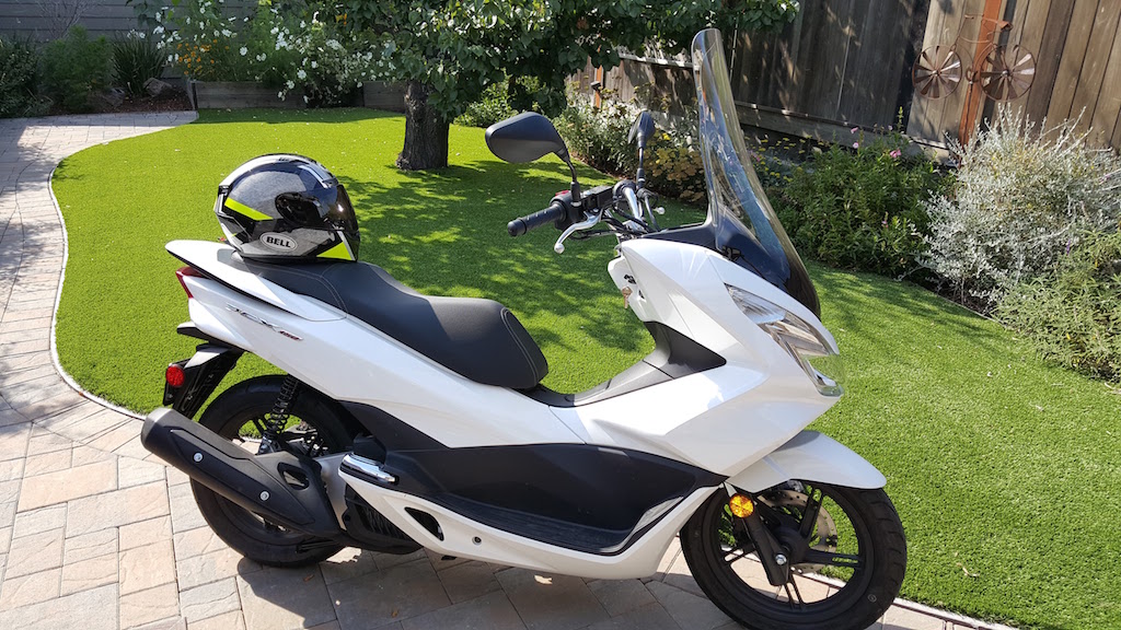

Welcome to the club! We have the same model year and windscreen. Honestly, I'm having trouble noticing a discernible difference between the stock windscreen and the medium National Cycle. If anything, I feel like the wind noise in my helmet has increased since switching to the National Cycle. Maybe I should've gone with the Givi.
I never apply the parking brake as I've found it to be pretty much useless, though my OCD has me disengaging the parking brake periodically. The stock rear shocks? I suspect they undergo a metamorphosis into concrete footings when I'm on the scooter and can't actually see them anymore.

That wind screen has GOT to keep a lot of airflow off the chest. Looks pretty aerodynamic, too. But depending on the design, there are penalties. Changing the airflow can make it so the wind hits the rider mid-helmet; that's turbulent and noisy. Clean air from the stock screen would be quieter, but pretty tiring on the highway at 60 mph.
A taller screen won't have either of those problems, but they often will give back pressure and reduce fuel economy. Also, since you have to look through them, the view is not as clear and it becomes critical to keep them clean. It's always a trade-off.
I have the Givi medium shield. Wind protection is a good compromise between the stock/non-existent shield and a tall one. But I do get noisy, turbulent air right on the helmet. I wear ear plugs nearly all the time when riding, which helps a lot, but I do wish it was quieter.
