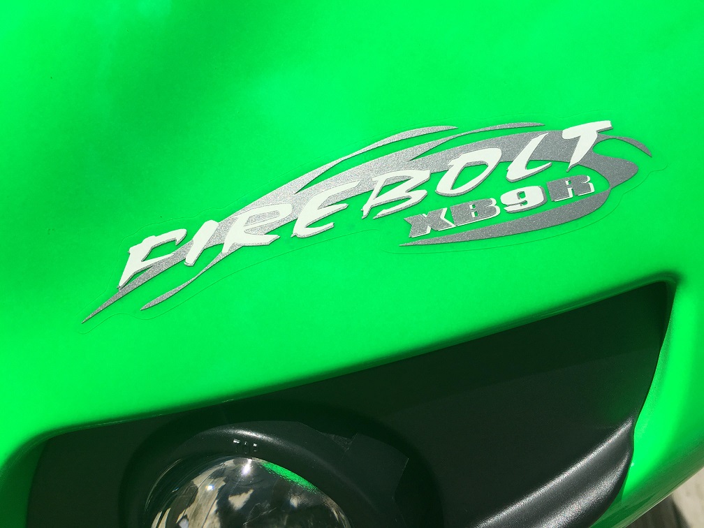

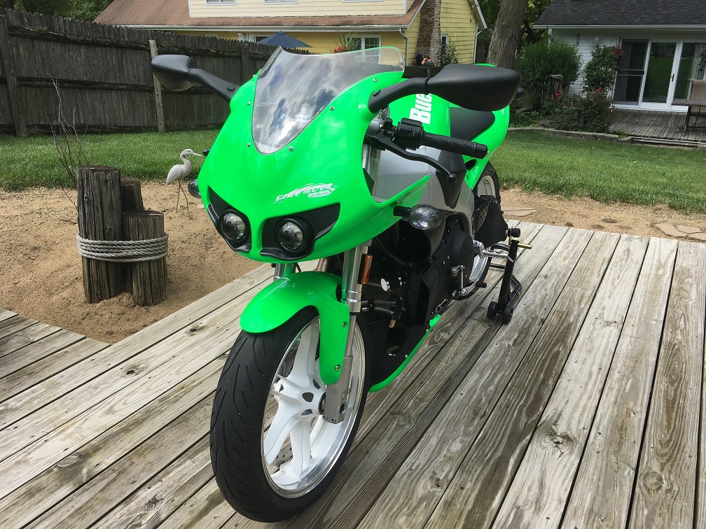

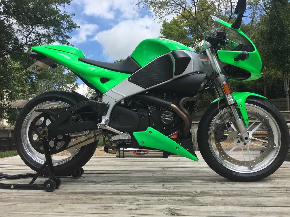

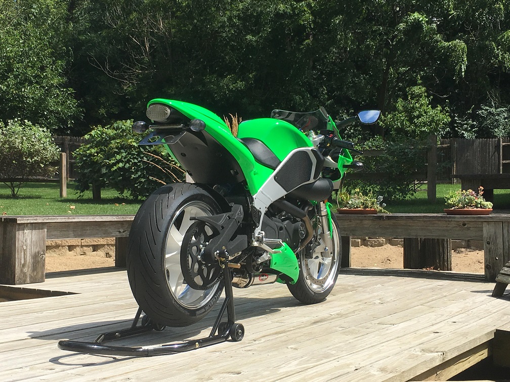

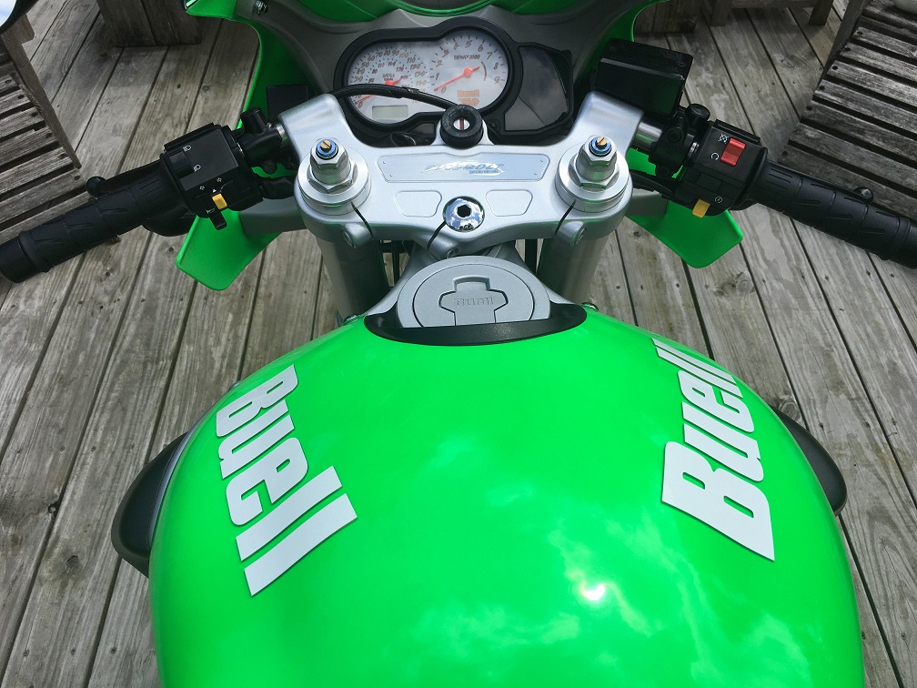

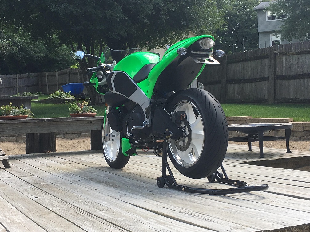

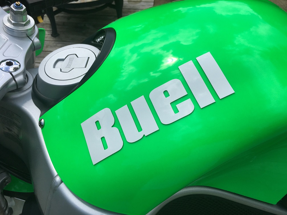

Learned plenty about paint on this venture :D
1. good primers are critical
2. avoid clear coating as it cheapens the look (that's what I hear) plus you can't rub out mares and light scratches in the future so NO clear coat on this bike.
3. cure time is a month... grueling punishment :roll:

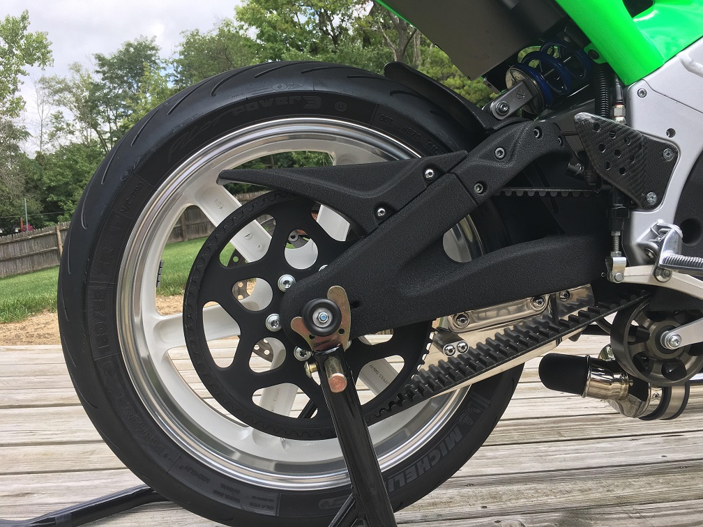

4. rocker cover wrinkle paint is fantastic for all your other bits
Sorry my phone camera cannot capture actual neon finishes in daylight and its overcast today so I thought it would be a better shoot 8) I'm not a photographer so I don't know why but the distortion off this sublime green won't behave in the daylight for a lens. The best image of the finish is the shaded front fender... weird.

Looks outstanding.
Disagree with #2- who said that?
http://www.best-auto-detailing-tips.com ... -coat.html

Lovely job, a very distinctive Kermit-esque look, but white wheels...?
I had a bike with white wheels once, bloody nightmare to keep clean. Never again.

gn2 wrote:Lovely job, a very distinctive Kermit-esque look, but white wheels...?
Yes white rims are gorgeous but monk me out after about three rides out. I found keeping good product on them helps brake dust and muffler soot wipe off easily.

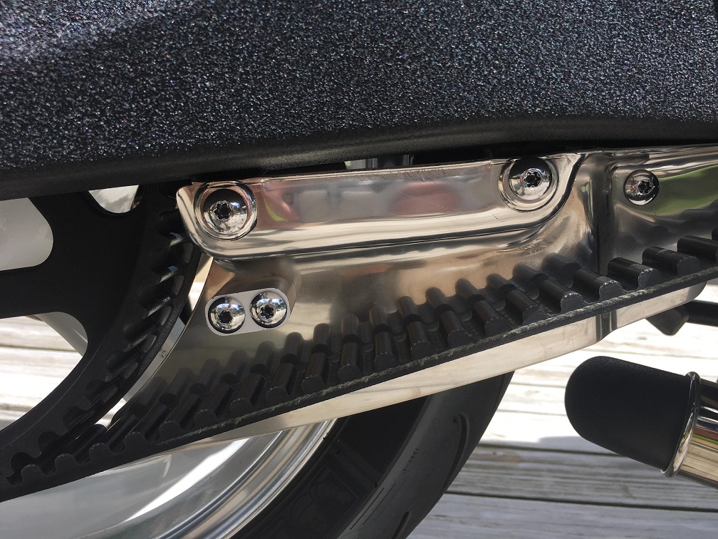

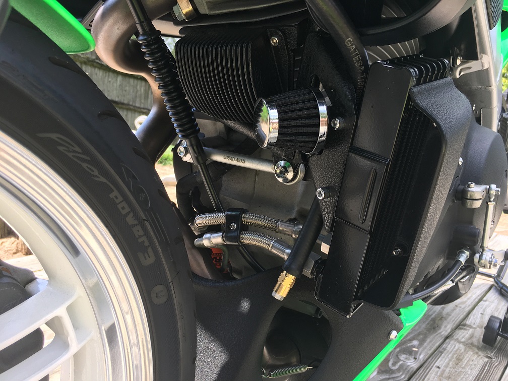

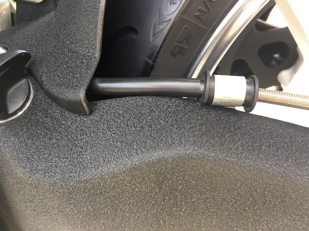

Thanks, I put a breather re-route this go round. The thought of letting engine blow by or oil mist enter the intakes after what I saw when I replaced pistons was enough for me to un-green. There is no connection from the PVC valves to the velocity stack anymore. The crankcase will breath through this little filter and any dribble ends up in that hose with this brass fitting. After a few miles I drain the dribble. But with the new rings there is little or none to drain ;) I spent hours polishing plates or replacing bolts, most are chrome now.

I also disagree. Clear coat is the best way for gloss, durability and repair. If right products are used clear coat system is clearly the best way to go..
Re: Paints cured enough... woot!
I see cars in our own neighborhood that have lost their clear coat, and they look really weathered. Definitely do a clear coat for durability and in depth beauty...though your paint job is beautifully done. Consider a clear coat for longevity. It is such a nice looking bike that you don't want to have to paint it again at some future date.
I appreciate the concern, garage kept, hand rubbed with compounds and wax is just a far more beautiful and quality dept of custom paint. If I was to coat over this with clear it COULD be less. Since I can opt for this anytime in the future and I don't intend to be green always (kept all the yellow skin and can switch out in 30 mins) I will hold on the clear coats :)
