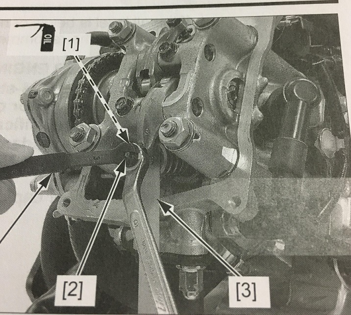

RuckinEMT... did you take to 7 in. lbs or 7 ft. lbs
- tappet1.jpg (110.98 KiB) Viewed 3554 times
- tappet.jpg (245.13 KiB) Viewed 3554 times
Re: Tappet Nut lost...
I know we are little help to find it, and I feel the pain for something that Honda claims needs doing that most likely doesn't. The ability to apply a torque wrench to this lock nut is tricky. Even the SM shows a 9m box end wrench on the lock nut. So how did you achieve the 7 ft lbs to this lock nut given the special tool it would take? Was it something like this...
Chief is dying right now looking at my tools, but how did you get this done?

And to be clear you had to rig something up like I show to get the torque wrench to work on a box end wrench... correct?

That is incorrect, you must hold the stem with a small wrench like in the picture to the adjusted specs you found with the feeler gauge while you tighten the nut to 7 ft lbs. Here is where things went bad for your engine. I have no understanding of what this did to the valves at this point but I suspect you need to take it in. And thank you for admitting the details. It takes a big man to follow up with a post like this. It can scare the crap out of folks doing this work and we must have conclusion.RuckinEMT wrote:Yes, I did know that. Also, No I used a 9MM socket on it...

Might not turn out too bad, I'm thinking the stem moved with the lock nut when you use a socket over the whole thing. It seems to me you would have lost whatever adjustment you made immediately and set your valve or valves way too tight. Probably screwed down as far as they could go and then torqued. Absolute ZERO gap then started the engine. Something had to give when the piston hit the valves... thus the little nut or nut's stripped off instantly. I take it you didn't go far?RuckinEMT wrote:That reference must be over my head. Again, thanks for the help...homie wrote:The ones who don't put all the nuts and bolts back properlyRuckinEMT wrote:the gorillas?The dealership

The clearance will almost certainly have changed if you didn't hold the stem whilst tightening/torquing. Nothing else to do but check the clearance again as the not ticking over is a symptom of out of whack tappet clearances.
It's always best to recheck them after you've set them as they can drift during the tightening process even when you hold the stem.

Also, note that those instructions from Honda mention a critical step - to oil the threads, so the measured torque is from a lubed surface, not a dry one.
..... am I correct that the torque wrench needs to be at a right-angle to the box wrench in order to get a correct reading? I'm almost certain that 'back when" we were re-torquing Norton heads and their mix of both head nuts and bolts (some of which being recessed in the side of the cylinder) we had to do this. I THINK we had to keep it at an angle to get it correct.The ability to apply a torque wrench to this lock nut is tricky. Even the SM shows a 9m box end wrench on the lock nut. So how did you achieve the 7 ft lbs to this lock nut given the special tool it would take? Was it something like this...
