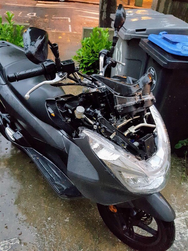

Hi, my PCX was stolen a few days ago in London. Police recovered it but it's badly damaged. I'm looking for an honest and good mechanic in London to restore it? I can't spend a lot of money and I don't want to activate the insurance - my excess is GBP 850!!!. Appreciate any help.
- image.jpeg (200.42 KiB) Viewed 1642 times

AH MAN! some people are just losers. WHY? I feel your pain brother. Is it just the upper front missing? Are your headlamps intact? Has the ignition been jimmied?

Headlamps look alright. It doesn't turn on but the ignition seems good to me, I'm able to turn the key, lock and unlock the steering, but the eletricals just don't work, something is not plugged and I can't figure what.
I hope it's just the front cover and nothing else, I manage to find the windscreen and it's intact, so that's about £100 that I won't need to spend.

How bizarre, so its not been in a crash. Ok looks like this thief knew what he was doing maybe. He turned out the two screws under the windscreen and removed the screen, the grill and meter panel so he could get to the ignition? Hot wired and went for a ride? If that's the case get your SM out and reconnect the connections to the ignition buy a upper front fairing panel and put this back as it was.luccasvr wrote:Headlamps look alright. It doesn't turn on but the ignition seems good to me, I'm able to turn the key, lock and unlock the steering, but the eletricals just don't work, something is not plugged and I can't figure what.

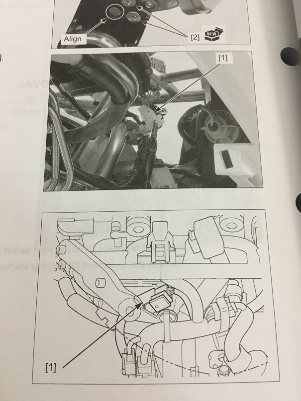

Do you recognize this location of the ignition 2p connector from the images? Does it look like it's been tampered with? One might be able to jump the starter from there if they had experience. If its been unplugged and jumped, clear out any jumper wires the thief might have dangling and replace the connector (hopefully nothing is cut) Then turn the key and hit the starter switch.
- unnamed (1).jpg (36.73 KiB) Viewed 1727 times
- unnamed.jpg (159.22 KiB) Viewed 1727 times

I got a mechanic from down the road to come and have a look. He was more knowledgeable than me and was able to have the bike up and running after checking the cables.
I'm waiting now on the front fairing panels parts - might be lucky and able to use the old windscreen if I can unbend the right side. The thieves also damaged both side panels, but I will leave that for now. They are £80 each and the store is asking me £150 service to replace (I will try do it my self if I can find cheaper online).
