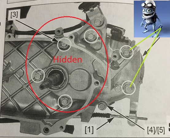

hondamatic wrote: I could try what easyrider suggested but I don't know the bolt torque to apply. I have the torque wrench, either inch pounds or foot pounds and not afraid to use them.
You could, IF that's the issue BUT you only have access to 2 case bolts and possibly 3 if you pull one little black plastic cover. To do it proper you need to pull the clutch pack off from under the CVT cover. Again if the leak is in fact the final reduction case gasket here are the 6 total bolts to be tightened in a crisscross pattern to 17 foot pounds. If it were me I wouldn't have a warranty anyway so I would already be in there :D For you to loosen and re-tighten all 6 in sequence wouldn't take much effort but you must at least ask the dealer about your coverage prior to the disassembly.
EZ proposes to torque only the 2 accessible case bolts out of sequence... I think you will be making a trip to the dealer to maintain your one year warranty ;) You can learn about taking the CVT cover, variator, belt and clutch pack off another day.

The good news, if EZ's right the gorillas will have to stand down. Take them 35 minutes to sequence those 6 case bolts 8)

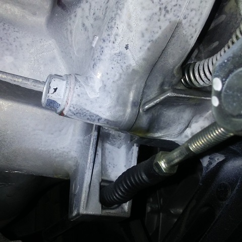

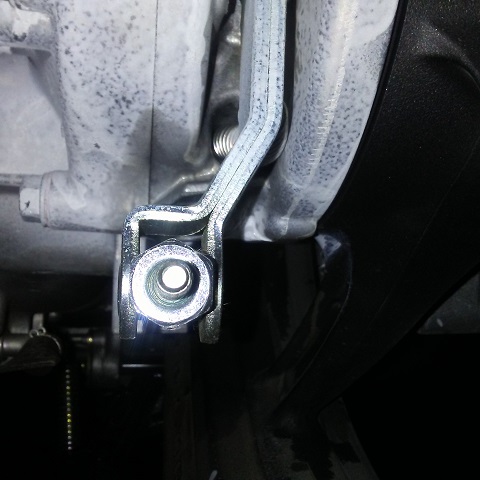

Ok latest update on my leak. I had left it at the dealership last Tuesday and they looked at it and cleaned the oil off the housing. The tech had ridden it about 6 miles and they said that they could not see anyplace that it had leaked. They sprayed some white powder all over the rear housing and told me to take it and try it. If I have any more leaks to let them know.
Well I have ridden it about 10 miles or so since picking it up last Saturday and low and behold it is leaking again...or still leaking would be a better choice of words. So I took a couple of pictures and that I have attached and it is as I suspected all along it is the gasket that is plain to see since they sprayed it on the housing.
They are closed today (Monday) but I will call them in the morning and make another trip to the city. Hopefully they can fix it this time.
Oh, I did torque the bolt that you see in the picture and it is torqued correctly to 17 ft/lbs.
More to come as I hear back from them, I will try to make another post tomorrow after talking to the service guy. They are an excellent dealership, this could have been found however if they would have just rode it some more....oh well, we have a new grand baby so that will take some of the pain away. I will take some time with him and pass the day away. Sorry for the long rant.
