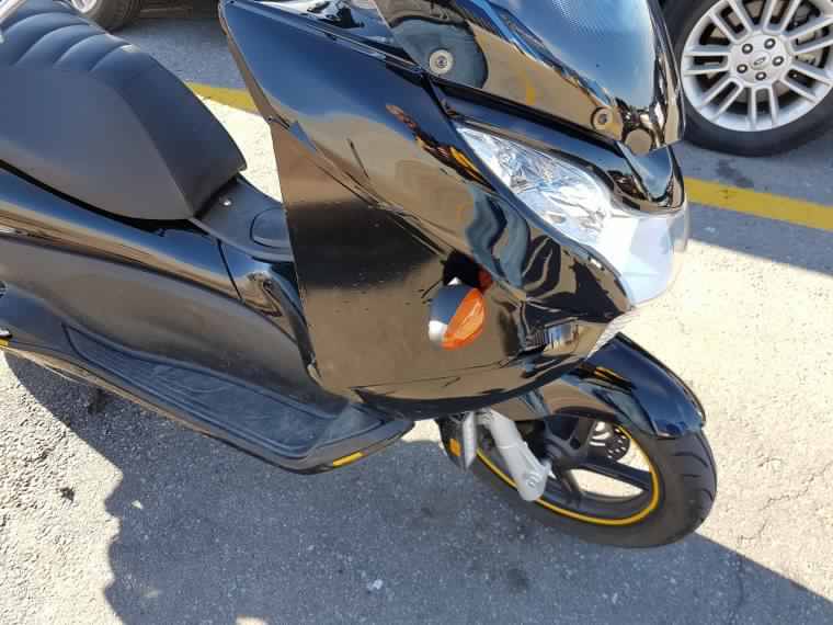

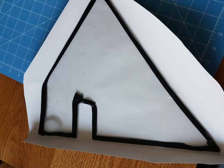

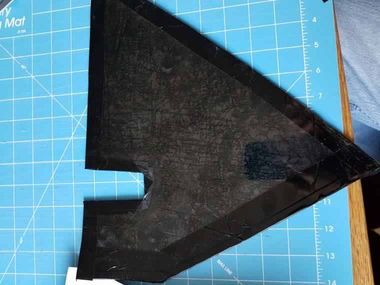

Hi all,
I decided to do something about my old knees not liking being blasted by air at near freezing temps(as I am 6ft tall).
I have seen a picture of black coroplast being used on ecommoder, but thought of a slightly different way. I used 5mm thick Plexiglas I had sitting around. I then made a cardboard pattern and cut the Plexiglas. Next sanded the edges down some and covered them with electrical tape to protect the bike's finish while attached. I purchased some black vinyl from a sign shop to somewhat match the bike's colour. Unfortunately I didn't have time to mix up some soapy water and do the job bubble free. But I applied the vinyl and overlapped it to the back/bike side. Then used wide scraps to attach the new aero bits on the bottom and top edges. Oh, and I used a wax and grease remover on the bike to promote adhesion. It works great on my occasional rides to Hamilton about an hour and a half ride on back roads.
It's still too early to tell about fuel economy changes. But I'll report back when I have confirmed. My first trip back from Hamilton I fought a 60km/hour headwind so not a good indicator.

Honestly no I haven't been wearing warm/purpose built pants. Plus I have knee problems anyway including having a large amount of meniscus removed in my left 16 months ago. But the little added panels are easily removable when the temperatures stay above 10C. Just thought it'd be a fun little experiment.

I didn't link to the older OWL style Daytona side visors, but Webike used to have them under the PCX 125 category.ScottDR wrote:Chicaboo, wow those are awesome! Just wish they'd fit with our North American turn signals. Too bad.
To make them fit the North American SNAIL, you would just need to trim around the antennae the same way you did.
Depending on how you cut them, it likely wouldn't weaken them, even though they are much thinner material.
I hope the ones you made don't chaff your paintwork over time from wind vibration, etc.
Re: Knees were too cold...
When I built ours I put duct tape on the body panel before attaching the wind protectors. I put car door edge trim on the outer edges of the wind protectors, and when we had our accident the panels stayed together, though they cracked all over.
Duct tape on custom paint, not good bed fellows. Especially these new Gorilla tapes. Next time you see a car who's owner duct taped a tail light or trunk down note the paint damage from residue after a little UV exposure from duct tape.
I guess that blue painters tape would work better. I just knew that I needed something to protect the paint. I usually took the wind protectors off in the summer, so I had just reinstalled them when we had the accident.
