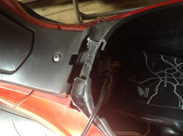

hi everyone still need to get my seat fixed from when I had to break into it, anybody have a clue what parts I need to order?

Re: locked key
You need a whole new luggage box: https://bikerzbits.com/storage-box-hond ... n-711.html
There are 3 types: original V1 non-eSP, V2 eSP, and the V3 LED. I think you're the V2 eSP?

Wouldn't a 2010 be a non-eSP? As I understand it about the PCX, it was first produced as a 2011, back in 2010. The way to tell if it is an eSP or not is to look on the side of the (I think) air cleaner cover, on the left above the silver belt/variator cover. If it does not say eSP, it isn't.
By the way, where are you located? You don't show it in your profile. If you were in the United States you could send for the luggage box for around $25. Also, just a thought, but you might be able to use something like an epoxy glue to reassemble the broken pieces on your present luggage box. It would have to be a very good glue, and you might even put a piece of metal as a backing to re-enforce it. Take the parts off of the seat hinge that need to be reattached first. The hinge itself can remain on the seat.
