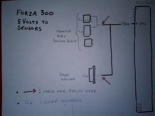

aguim
- Posts: 274
- Joined: Sat Nov 05, 2016 2:03 pm
- Year: Forza 300
- Color: red/2014
- Location: northern ontario
Re: 8 lights from FI
Here is a simplified diagram of the 5 VOLTS FEED TO SENSORS.GolDen wrote:Hm...
Ok. What i decide to do...
Check y/bk wire connector s.
Open left side. Make link to y/bk wire to get information have 5v or not on-line. (Put small +5v voltmeter on it)
When yellow lights come in... We will see...
If +5v disappear.... That mean, that i need to change ECU?
What you should do first is : disconnect the DROP sensor and check for 5 volts at the Y/Bk wire.
If 0 volt there, go to the throttle body, disconnect its sensor block, and check its own Y/Bk wire
for 5 volts. If 0 volts there too, the ECU is probably faulty.
To make sure the ECU is really at fault, go to the ECU (still connected), and take a reading straight from its Y/Bk wire output by gently piercing its protective isolation (a delicate operation). If 0 volts
there too, the ECU is KAPUT. If 5 volts there, the wiring between the ECU and sensors is OPEN
somewhere.
It's all a matter of determining if,or not, the different sensors are fed the normal 5 VOLTS.
NOTE : the MAP sensor is also getting 5 volts from the ECU (Code#1, one short blink). So, with the
ECU faulty, you should see in succession :code 1, code 8, code 54.

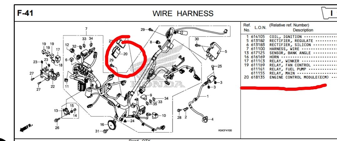

Guys. Could you sent me any picture, how can I reach to the ECU box?
Is it need a lot of disassemble? where is that damed box?
How much it could cost?
cause if I disassemble my lovely bike... its Thailand.... it could takes a 2-3 weeks to order the new ECU
If its not too expensive.... may be to order the new one is a good idea....

hm.... according that pis...
I need unit #20
As I understand, that under right plastic body... under the sit...
Cost about 80$... not too much...
Will buy anew one and ask mechanics to change...
I need unit #20
