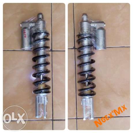

kawasaki KX85 rear shock with preload/rebound set on softest settings.
makes a huge difference....
used one on my pcx125
i weigh 190lbs
