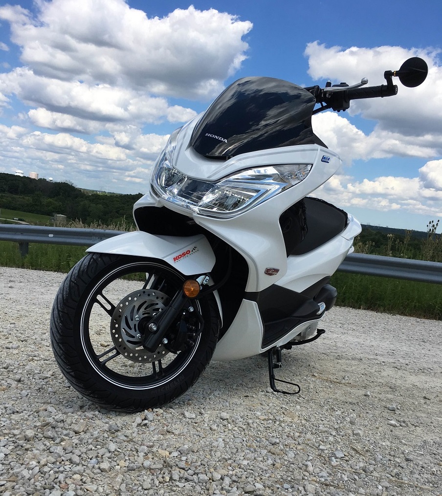

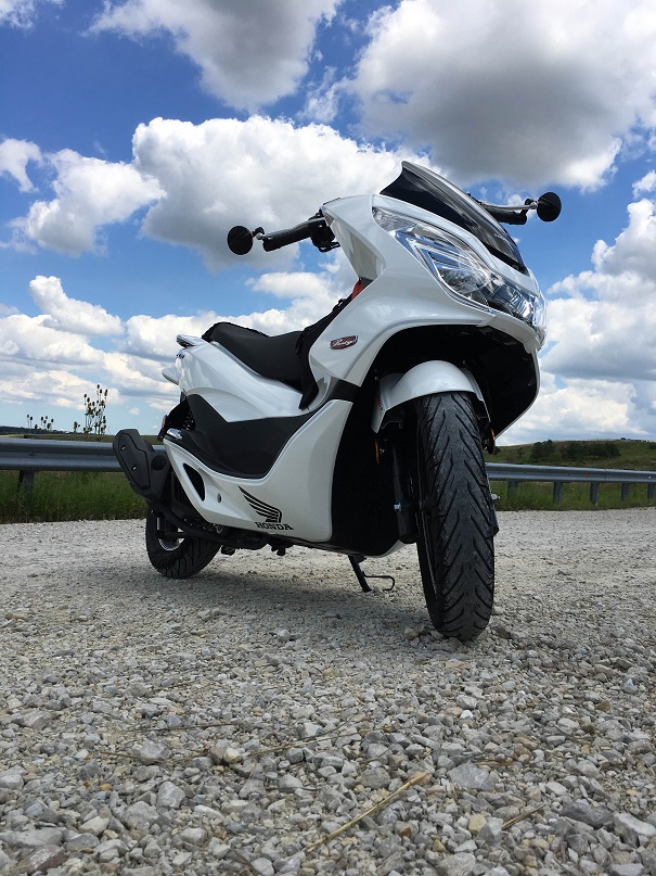

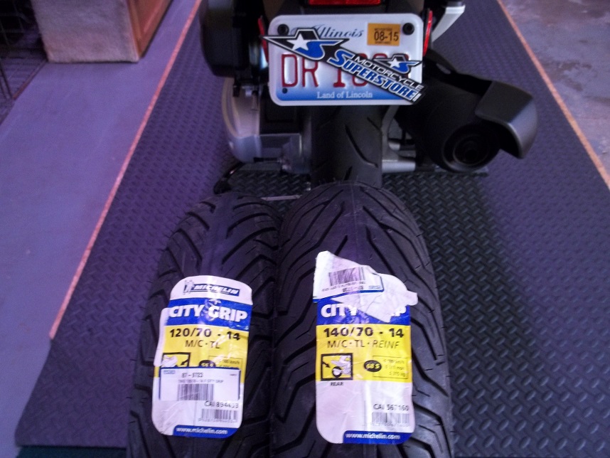

150 will not fit... 140 rear will if you space off the airbox 3/8 inch and the fender 1/2 inch. 120 fits the front no modification at all.
