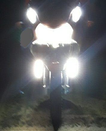

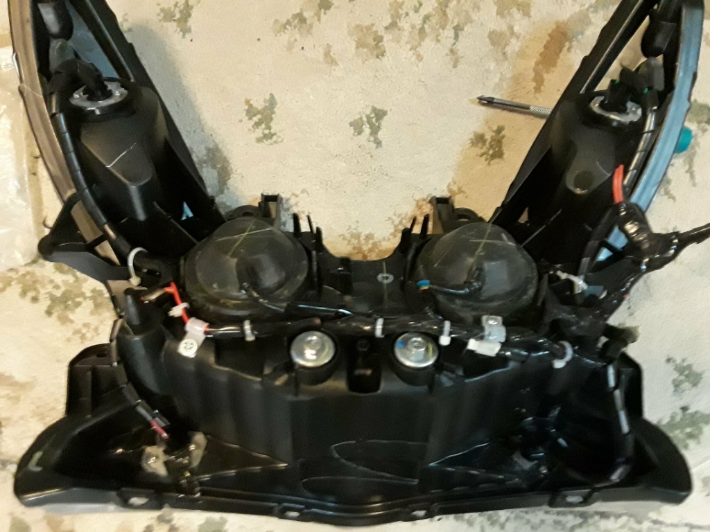

Also, the headlight assembly for the 2013 model in the United States only uses the main headlight sockets. I pulled my assembly, drilled out places for additional sockets, wired them up and now have quite a bit more lights than previously.
Newly wired headlight assembly
I also have spotlights on each side of my front forks with a switch on my handlebar. I have plenty of light at night now.

Oldguy...come back, we need your input to go further. Cha cha cha...in the meantime we'll be tossing in some humor. Chuckles are good for the soul. Upwards wrinkles always better than downwards (Damn gravity!)
OhMy God NADman! Look at All "That!" :lol: Is that a buried Vespa? Spotlight heavy? Ya think? :lol:
"Blinded by the Light...."

I can't imagine those additional lights on that scooter actually working. Ok, maybe with an extra battery and alternator. Hmmm....so what do drivers say when they see that "thing" coming at them?!
