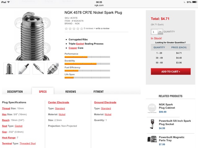

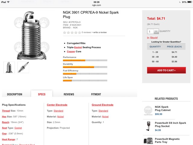

I think I know the answer to this but here goes. When I had my Burgman I purchased a new spark plug for future use. Then I traded in my Burgman and forgot about the spark plug. Today I found it by accident and wondered if it would work in my pcx. I am betting that it won't. It is a NGK CR7E. The book says to use a NGK CPR7EA-9. I have no idea what the difference is. Whatever it is I am betting that I will be giving the spark plug away to a new home.
- Alibally
- Posts: 1761
- Year: 2019
Re: Upgraded spark plug for PCX?
The spark plugs are different. One has a protruding electrode and the other doesn't.
For the price of the plug I would get the correct one.
