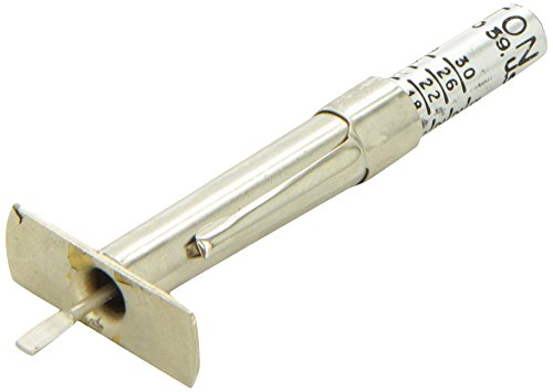

I just installed Michelin City Grips on my PCX and only have about 100 miles on them so far. Tires here in the US are typically measured in 32nds of an inch (0.03125" or 0,8mm). My rear CG has 6/32" or about 4.8mm, and the front has 5/32". Car tires here often have 10/32"-11/32" for All Season tires and 12/32"-13/32" for winter snow tires. I use a tread depth gauge like the one in this picture:
