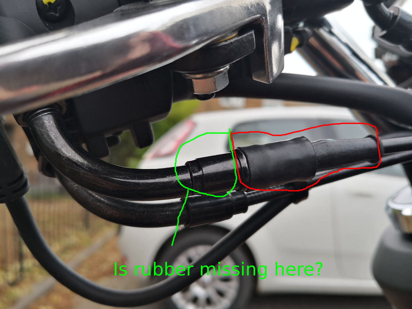

I've bought a PCX 2019 model, or 2018, whatever they call it. I have requested Oxford heated grips to be installed but it seems to be they are behaving strangely since they are too loose regardless if I tighten the throttle cable. I have attached the video. Basically, the throttle goes back to it's place and you can still close it further (you can see on the video how much further I can close it). I started the engine to test as well, when I release the throttle the engine is idling correctly, but that additional loose space is annoying. Do you have the same thing with the original grips or Oxford heated grips?
I also wanted to ask if the rubber on your throttle cable is short as it is on mine since mine does not cover the complete nut and lock nut area.

- Throttle Cable_2.jpg (307.29 KiB) Viewed 4429 times

Hi, I have Oxford grips on my 16 model, I fitted mine with out taking the twistgrip apart so did they strip it apart and forget to adjust the cable also where the electric cable enters the block looks close to brake lever in the wide open position

My thought is that they stripped it apart because even when I close the throttle to the very end it feels soft, not solid, like it came to an end. I think I will have to open and check.

I have checked once again. The dealer definitely didn't replace the plastic tube. The problem is most likely with the cable, it's either wrongly routed or it needs adjustment at the engine side. I will take it to the dealer for inspection.
