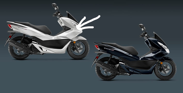

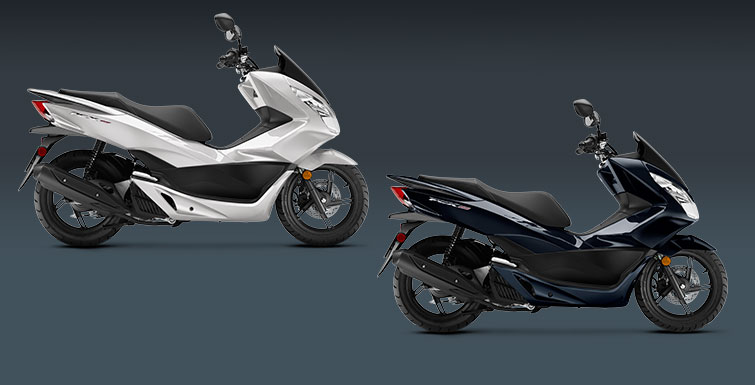

Here is a 2018 model. Note the closed V front.
Re: How do I find which year Honda PCX I own?
Posted: Wed Oct 03, 2018 12:50 pm
In case you are not sure what I am referring to when I mention the closed V, here is a picture of the 2018 in which I drew an arrow to the area. I hope this clarifies things better.

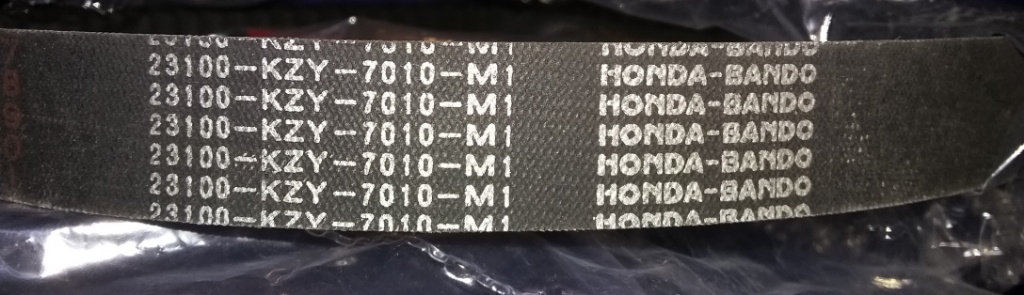

By the way, my drive belt part number is different from yours. Of course, mine is a 150cc and I am not sure what yours is. Here is a picture of mine. I can't find any references to the part number you gave, though.
Drive belt for 2013 PCX 150.jpg (132.57 KiB) Viewed 20288 times

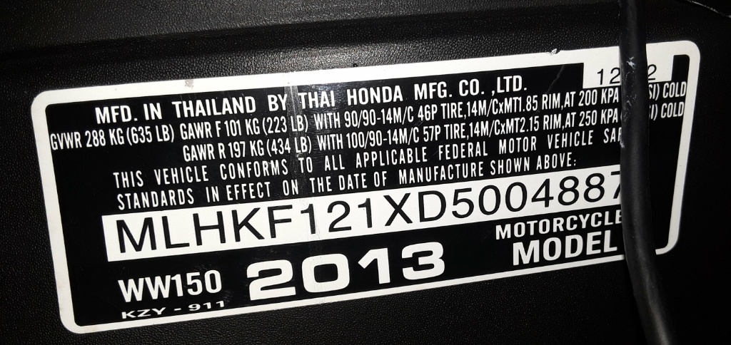

I was not implying anything by that, I am simply pointing out that the vin number is universally put somewhere on the bikes, but also are required to be very visible on the models going to the United States, so we have a plate attached to the right front panel close to knee level where everything is in big letters.
PCX-vin plate.jpg (241.17 KiB) Viewed 20190 times
Other scooter brands have their plate below the front of the seat.
In Sri Lanka there may or may not be a different requirement. If there is none then you would probably be using the numbering stamped somewhere. Since I don't have the slightest idea where that other place might be, I thought that it MIGHT be possible that you didn't either. Sorry if it came across as other than that.
