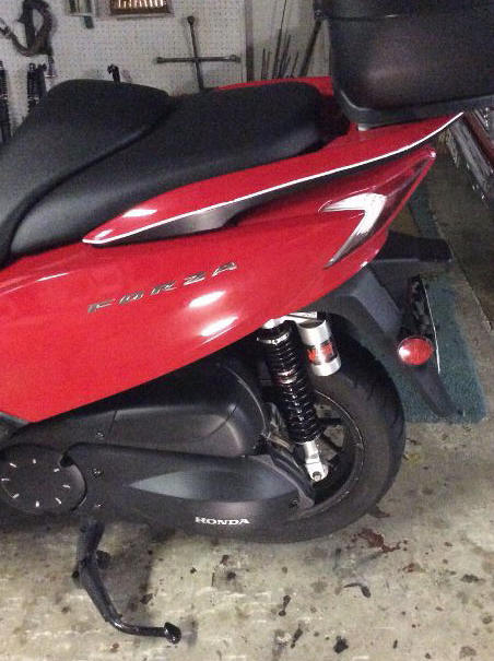

Rough ride is my only complaint with my 2014 Forza. I weigh about 63 kg (140 pounds) so I "work" the suspension less then you. I have mine set on the lowest preload setting and it's still to hard...especially on sharp bumps like pavement expansion joints. Have you bounced up & down on the scooter to make sure the springs/shocks aren't seized up for some reason? I just bought off eBay these YSS shocks from a dealer in Britain...
https://www.ebay.com/itm/Honda-NSS300-F ... 2749.l2649
They claim they come with springs for people weighing over 12 stone (168 pounds) but will replace the springs with lighter ones for lighter riders (I'm at 10 stone). Unfortunately they only list one pair of these...but maybe they can get more if anyone is interested. Will report back how they do once I get them...hopefully before the snow flies!

The shocks came this week, just in time to make a comparison ride between originals and these new YSS shocks. These shocks are YSS TC302-400TL-030-85-x, fitted with slightly lighter springs for may 140 pound riding weight. They have a screw adjustment for spring preload but no adjustment for damping. With the preload on the bench set at "0", I found the ride somewhat better then the originals...that is, the ride seemed less "jarring" to my back and rear end over sharp bumps. Not a big improvement, but on a parr with my 1986 Elite 250...which is pretty much what I was hoping for. I did encounter one deep bump where these shocks bottomed out...something the originals never felt like they did. Will try increasing the spring preload a bit (it's a screw adjustment, so you can make, easily, small changes) to see if that prevents bottoming, That will have to wait a bit, as we got some rain & snow showers today, with temps not predicted to warm up much the next few days. So...are they worth the price...Maybe. There does seem to be an improvement in ride as hoped, but not a big change.I like to "fiddle" with my toys and make improvements, so from that view it's been at least enjoyable.
