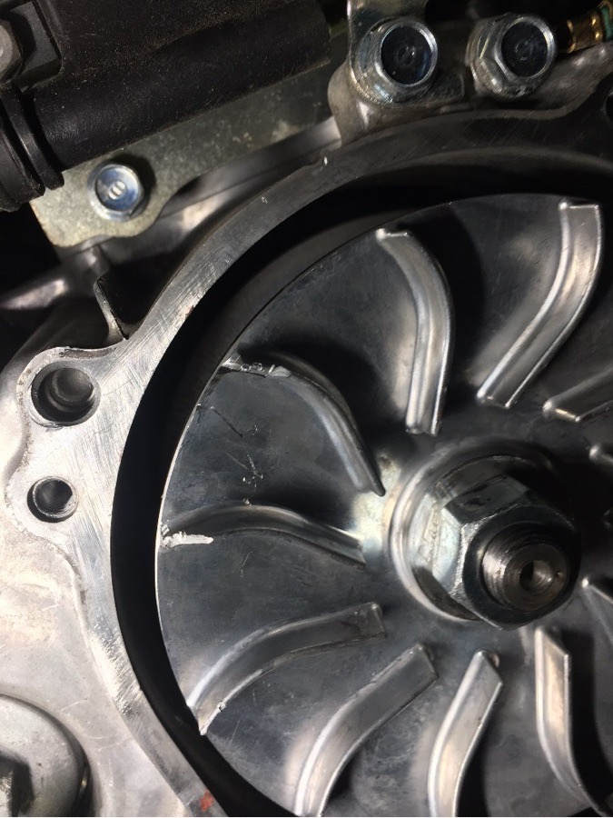

I damaged a couple of the fins on my new NCY drive face when trying to torque the nut down and hold the variator with the holding tool. It looks like I took a chunk out of one of the fins, and gouged up a couple others. What does this piece actually do? Will this damage be an issue? Or am I fine to keep using it? If it is a problem, can i put the stock one in place in conjunction with all of the other ncy stuff until a new drive face arrives?
On a side note I only managed to get the nut torqued to about 30lbs, going to have to find another way to do this. It drives but sounds louder and feels different. It also makes a rattling noise now so something isn't right. Not sure if any of this is related to either the nut torque or fin damage or is another issue altogether. Anyone have any advice?

The fin damage is minimal ,however unlikely it may cause an imbalanced rotational force.
Hope nothing is bent or out of round with the broken fins.Check for smooth rotation and look for any abnormalties.

Based on my limited knowledge, the fins are there to act as a fan and ventilate the variator for cooling purpose. Probably not of a big deal.

The fin damage isn’t an issue but the undertorquing could be if the nut comes loose.

If you spin that at 8000 rpm it will be out of balance without doubt. Even if it does not look like a lot of mass is missing, centrifugal forces are in play- i would replace the part.

When I reinstalled an OEM drive face on my bike quite a while back I broke some fins. I was told to go to the opposite side and try to break those fins about the same as was on the other side. That way they won't be out of balance. However, in your case I think that I would put the OEM part on and order a replacement NCY drive face. To tighten the nut, don'the try to use the normal tool. There are no holes to put it in. Try a large rubber strap wrench. It should hold, though it may be a little tricky to attach at first.
Re: Damaged new drive face when torquing. Is this an issue?
Mel46 wrote: I broke some fins. I was told to go to the opposite side and try to break those fins about the same as was on the other side.

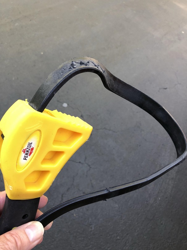

to the original poster;
Go get another face and use a large oil filter removal tool (the rubber band type) The band will take abuse but you'll achieve the 44 foot pounds without breaking anything. To be honest I took this short cut once with a socket wedged between a fin and one of the CVT bolts. Confident one fin could take the pressure I was successful one day but chipped a fin another... lesson learned.

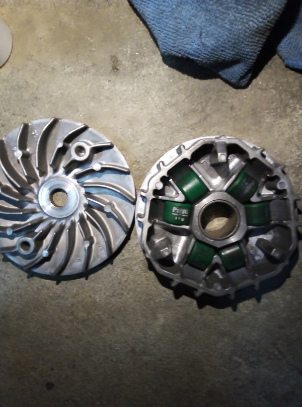

I'm not sure what's going on here. Now I can't remove the new NCY drive face at all. I got the nut off but the drive face won't budge now. It's like it's welded itself to the scooter. I don't know if I installed something wrong/backwards or what. I'm pulling on it with all of my strength and will not come off.
https://imgur.com/a/3M93bbH
Is he missing a washer?romnation wrote:I'm not sure what's going on here. Now I can't remove the new NCY drive face at all. I got the nut off but the drive face won't budge now. It's like it's welded itself to the scooter. I don't know if I installed something wrong/backwards or what. I'm pulling on it with all of my strength and will not come off.
Looks like the pulley face was forced/jammed against the shaft ridges from his twist with the holder - instead of the nut tightening first? Was there play on the shaft with this non-stock part?
Might need a gentle pull from a puller.

It looks like I did forget the washer. Doh. I examined everything and all rollers look to be inserted properly. I'm still having problems getting the nut torqued past 30ft lbs even with the rubber strap wrench. Is there some sort of low powered impact wrench or something I could use on this without damaging anything?fish wrote:Is he missing a washer?romnation wrote:I'm not sure what's going on here. Now I can't remove the new NCY drive face at all. I got the nut off but the drive face won't budge now. It's like it's welded itself to the scooter. I don't know if I installed something wrong/backwards or what. I'm pulling on it with all of my strength and will not come off.

So I guess the washer was the entire issue all along. After putting the washer on I was able to easily torque it to 44ft lbs, without the use of the strap wrench. (Just used the holder tool again and was careful, didnt break any more fins) No more rattle either.
