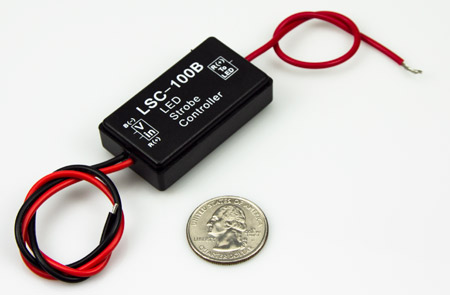

I just purchased a set of these. I have not tried them yet, but It seems to me that they should do what you want. I plan on connecting them to my small strobe lights because they have stopped strobing...either that or they no longer work, in which case I have other LED lights that should work with them.
https://www.superbrightleds.com/moreinf ... e/196/846/
Re: Headlight modulator.
Posted: Mon Sep 17, 2018 11:43 am
When you go to that link you will find that they have a few strobe control modules, and they are not that expensive, so you could just try one to see what happens. I noticed on the particular one I pointed out that it has the same description ON THE MODULE IN THE PICTURE as their LSC-100A (the picture should show LSC-100B) . The 2nd picture has the correct description on the module and should look like this:
They have some nice little products. I don't know about their quality, but they are cheap. I have a few of their items on my bike.
Posted: Mon Sep 17, 2018 4:01 pm
Looking at this strobe controller, it looks like, unlike a modulator, it may only be connected to the low beam, and instead of flashing between the high and low beams it may just strobe your low beam. Real headlight modulators cost around $75. It may be better to improvise.
It may be to your benefit to add LED accessory lights and stobe those instead.
Here is another controller that may do the same but will give you more control.
https://www.superbrightleds.com/moreinf ... 1082/2573/
and another type:
https://www.superbrightleds.com/moreinf ... 05EALw_wcB
