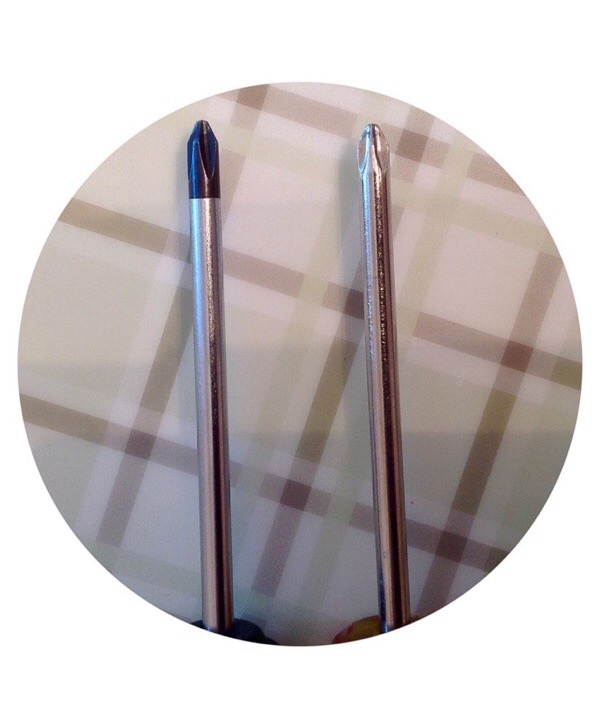

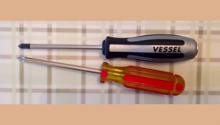

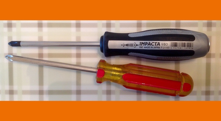

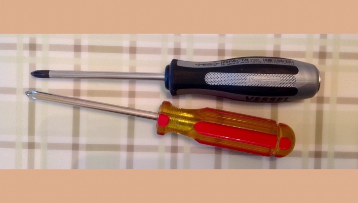

Own and use Vessel myself.
Lock in and turn!
Some comparison pics of #2 tips - my "junk drawer" Stanley driver and fav, the Vessel.
Bit more info...Vessel has a non-slip grip and good weight to it. Even includes an impact head. Tip magnetizes easily.
Fetch screw. Set it. Twist it. Even Strike it.
(My Dad would've loved these. Would've made a great gift!
Jot that down peeps) :D
