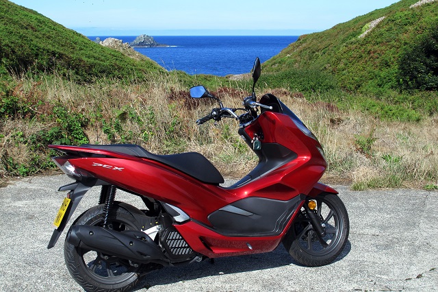

Just got over running in mileage by visiting Cot valley nearby in Cornwall
