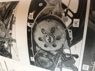

If you have a hesitation or vibration right when you take off, it's probably the clutch shoes that are glazed over and not making good contact, this is a relatively easy fix. See some of Maddie's other posts on how to take off the side panel underneath the floorboards, and then take off the cover to the clutch/variator area. The clutch vice grips used to hold the variator can also be used to hold the clutch, (or Some just hold the back brake shut)…
use a big socket to counterclockwise loosen the 19 mm (#3) nut. Pull off the clutch basket and sand down with rough sandpaper the clutch shoes and basket, they are staring you right in the face then wipe down with alcohol or brake clean. Reassemble using a TQ wrench at 36 ft/lbs on the nut.....vibration gone
