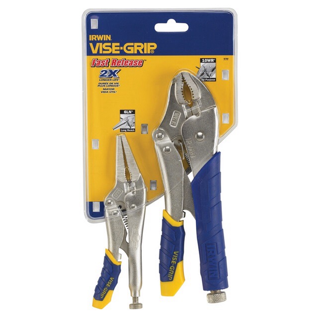

It is very easy to cross-thread that particular bolt. I did that once and I had a heck of a time getting it out. I eventually used a vise grip on that tiny head and was able to turn it a little at a time. What a nightmare. Good luck.

Hard to tell by that picture but it looks like the crown of the screw is ripped off. Try a small easy out, or like Mel says use small vise grip and hope you get a bite on it. You can also use a small sharp punch and work it out little by little with circular taps with a small hammer. Worst comes to worse just drill out the plastic around the screw and lift off the panel. Once the panel is off then you can grab it with the pliers and work it out. Replace panel without that screw or use a wide washer.

On my iPad it looks like the head broke off? Yes, as said use a "well kept pair" of vise grips. Set them on it as precise as possible, lock then turn slowly in increments. I've stood surprised many times as this tool did it's magic. Work with it Slowly. Keep us posted :)
IF that doesn't "bite it" then onto the next solve:
