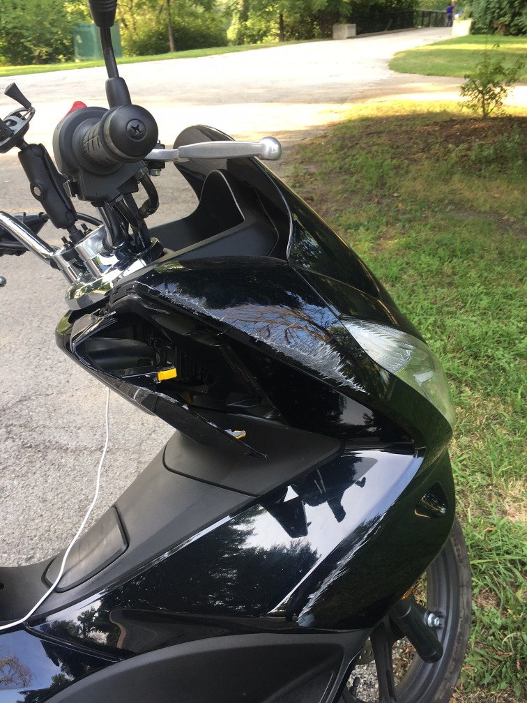

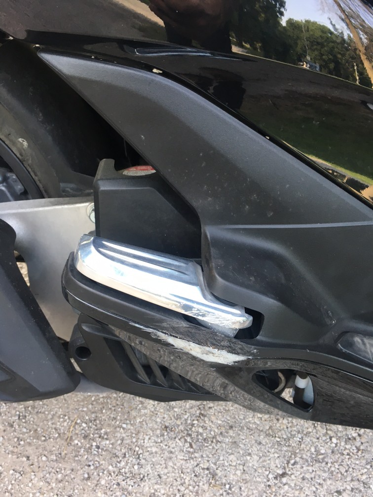

Sorry guys, I gotta add to the list here...
So I was making a turn in a park at a very slow speed, around 10mph. I saw a little gravel and slowed down appropriately. What I didn't see is the thick sand under the gravel. As such I crashed while making a turn and slid the right side of the bike. Nothing wrong with me except a minuscule scratch on my leg.
As for the bike, do I have anything to worry about besides replacing fairings and plastic parts? Is there any way a crash such as this could have caused any frame damage? Here are some pics and list of damaged parts (that I can see)
Right Side floor step
Right side foot peg
Muffler cover
Plastic cover where the ignition/seat switch is. (this seperated during the crash and I managed to break it more trying to force it back in)
Front right plastic fairing
Bottom right fairing under footwell
Front right mirror.
I'm reasonably confident I can make these repairs myself. One of the things that concerns me is how the plastic separated near the speedometer in the pics. I can't get it to clip back in fully but I think it may just be that the top clip got bent, as it feels a little bent. Can't really tell without tearing apart the bike and I'd rather wait until my parts arrive to do that.
Anything I should be worried about here? Bike feels solid.
Right side foot peg
Muffler cover
Front right mirror.

My fiancee's low speed low side also bent the fairing stay (internal frame everything attaches to) on her silver wing - if you also did that it could be why things aren't quite lining up toward the top of the bike.

Any "get off" is devastating but coming away from it uninjured or in reasonably good health is number one!
Sounds like you are OK. . .. That is the good news!
About the PCX. The not-so-good news. . .. A fair amount of body panel damage. A real Bummer. . ..
Yes it will cost time and $$ but life is more important than stuff. The upside is it can be restored.
You said the "bike feels solid". It leads me to believe you rode it home?
See if you can answer the following questions to yourself, knowingly, one way or the other. . .it's OK? or it's not OK?. It's a good place to start to get an overall assessment of the easily identifiable issues. And again I reiterate it sounds like you may have ridden it home. . ..
No fuel leaking anywhere?
No damage to the engine or final drive?
No bent handle bar? Levers?
Wheels seem in alignment and no damage to the suspension?
Front disc brake caliper functioning properly? Rear brake doing OK?
Engine starts and runs on the center stand without a hiccup? Shuts off without any dieseling?
Gauges register fuel capacity, time, mileage, MPG?
Lights work?
Horn and turn signals work?
Basically does every thing function OK?
As a side note, don't give the engine any throttle on the center stand. . .just see if it runs OK. As you probably already know that rear wheel spins when the clutch grabs.
If things, other than the obvious damage, seem OK then it probably does come down to cosmetics/panels, mirror, and that ignition switch issue that need to be remedied. At the end of the day ask yourself how "good" do you want it to look again. . .all things functioning properly. Some riders may go the cheap route and just get some touch up spray paint and a little sandpaper and have a go at it to just make it look less ugly. Others may want to look like new again. Choose what works best for you.
Most of us who ride have had that "Baptism of Fire" at one time or another. Just try to learn from it. . ..
I'm sure others will chime in here with good ideas but one suggestion I have is to make sure the coolant tank didn't get cracked or is leaking. It's mounted right behind that right passenger foot peg.
If there is any doubt in your mind about functionality you may consider taking it to a Honda dealer mechanic for an opinion. . .or even a $$ estimate to make a more informed decision to resolve your problem. Safety first!

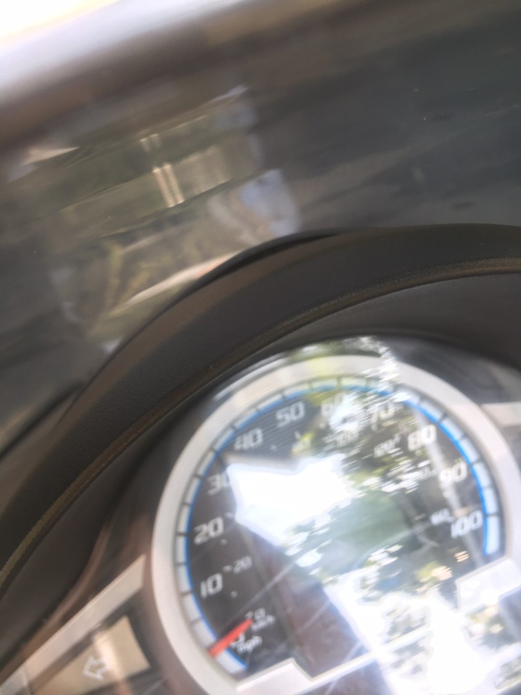

Can anyone do me a huge favor and post pics of their dash. I managed to get some of the clips back in and get it looking a bit better but there is still a bit of a gap. I'm starting to think this may be something I just have to live with... I imagine it would be quite a bit of work to replace the fairing stay if that is the case. I mean the only person who will notice it is me, but I am a bit of a perfectionist when it comes to vehicles. Here is what it look like now.
