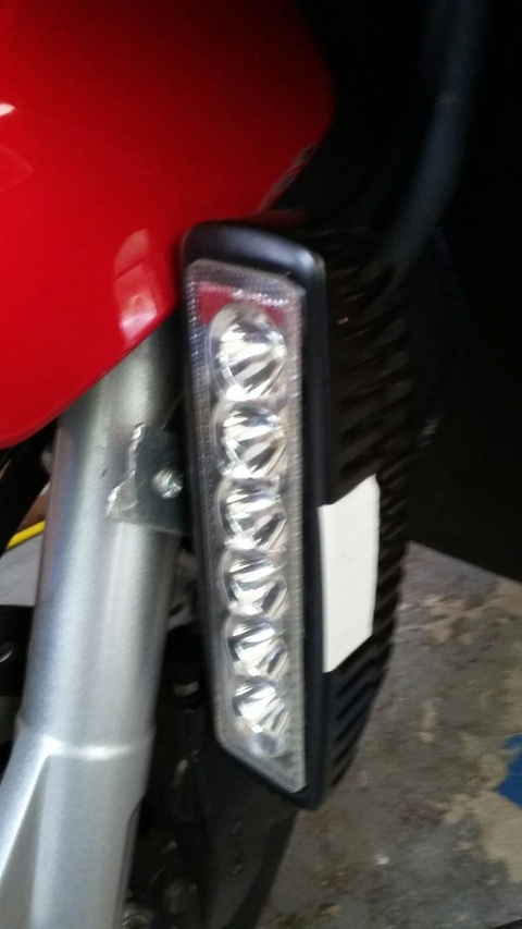

these are kawell lights off amzn....splice into the power port under windshield, or mount complely Vertical off the wheel reflectors:

Also installed my kawell lights this morning. Same lights as above. Mounted them to the existing reflector bracket. Just removed the reflector. Had to use a spacer and longer bolt to get it right. Considered mounting where the reflector bracket attaches to the bike. Didn't have the right spacer or bolts. Looks similar to all the other photos. Spliced the two lights into one wire and then that one into the ignition wiring. Light turns on after I turn the key unlike the headlights which don't turn on until the engine is started. Not bad. Took a couple weeks to plan and find the right wiring place. Pics if anyone wants to look. https://drive.google.com/folderview?id= ... x07xx2IDjV

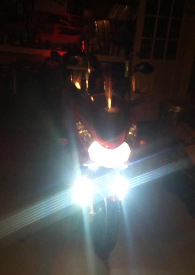

I have mine located there and I set them up on a switch on the handlebar. I did this because riding at night is dangerous enough that if a fuse blew and took the main lights, I would want lights to get me to a safe destination. Of course, I believe in overkill. I also have some baby strobe lights and wheel well lights that I have a switch for as well. Plus I recently attached two led spot lights to the mirror bolts as well. Yep, overkill.
I did, however, set up some of my accessory LED lights so that they would come on when the bike starts. ...and you should see the tail lights. :roll: yep, overkill.
Oh, and I updated the headlights to HS5 bulbs and added lights to the empty sockets. :-)

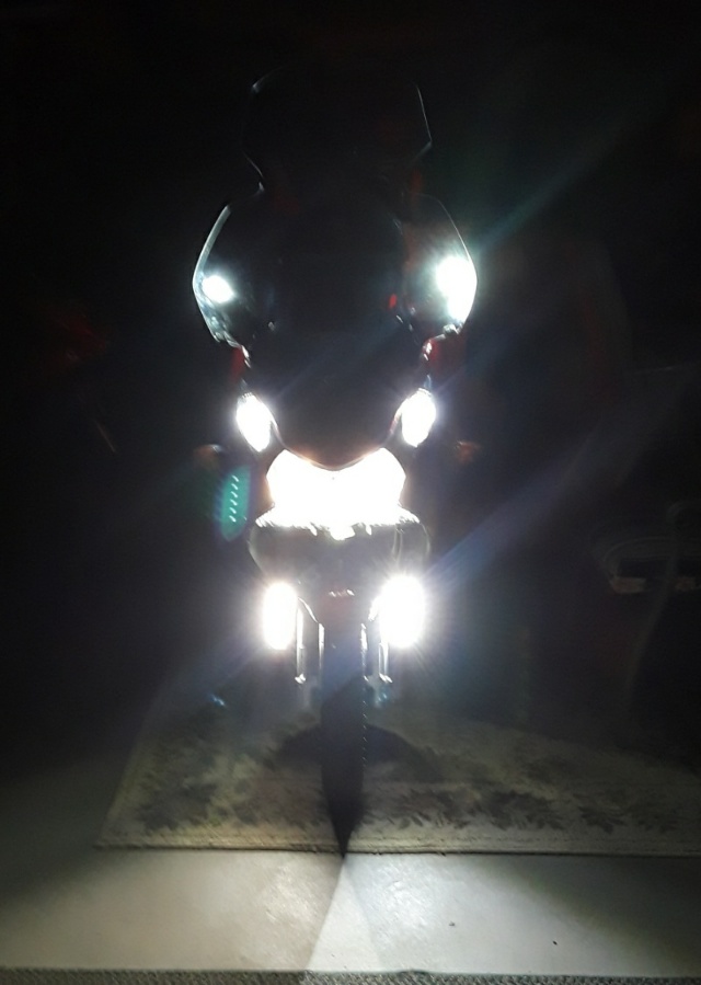

Here is a picture of the full light affect of me riding down the road at night. Can you see me now??

Had some electrical issues and one light stopped working. Loose connection and fixed that. Both work again. More secure and waterproof. Moved them up to where the reflector bracket attaches. Better balance on each side. The brackets weren't symmetrical. Looked a little cock-eyed. Much better now. Used a one inch stainless steel spacer to get around the fender, wider washers on each side of the light bracket, and a M6-1.0x65mm bolt and used the original nut. Used the left side cover (variator cover) long bolt as a "practice" bolt. 65mm is perfect length. That left side cover bolt has a 8mm head but the new one is the larger (and better) 10mm. Once torqued tight, it is difficult to angle up or down but once I find that sweet spot, it will not move! Angled around 15 degrees forward from vertical right now to not blind oncoming traffic. Any angle closer to vertical is much too bright for other cars. WOW are the bright! Considering a switch for when I need to turn them off. I love working on this scooter!

Kawells mounted on reflector position. I replace them about every 18 months just to keep them corrosion free.
