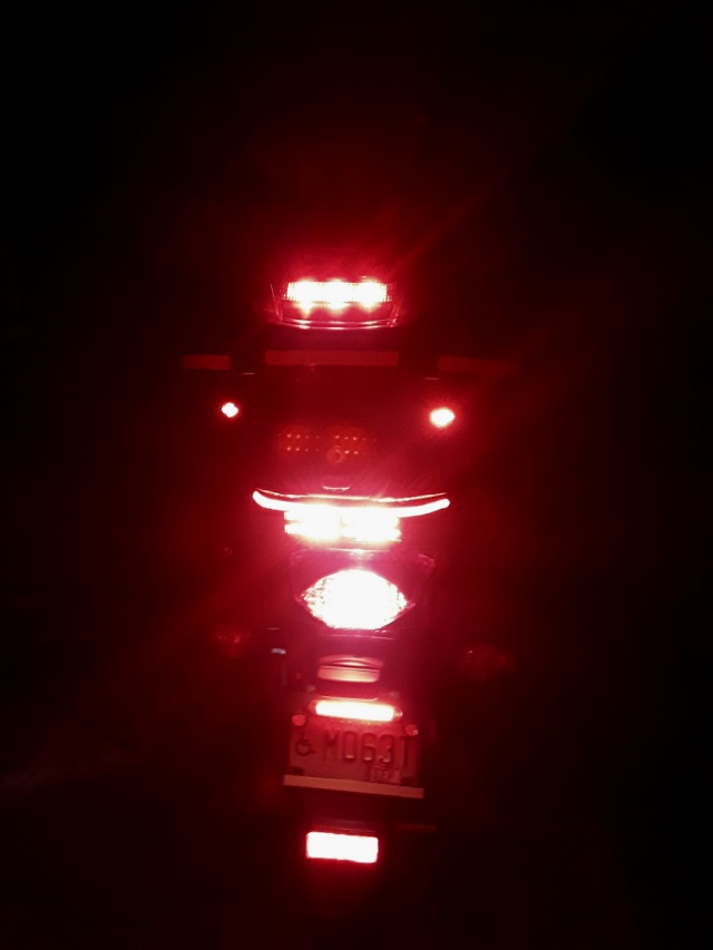

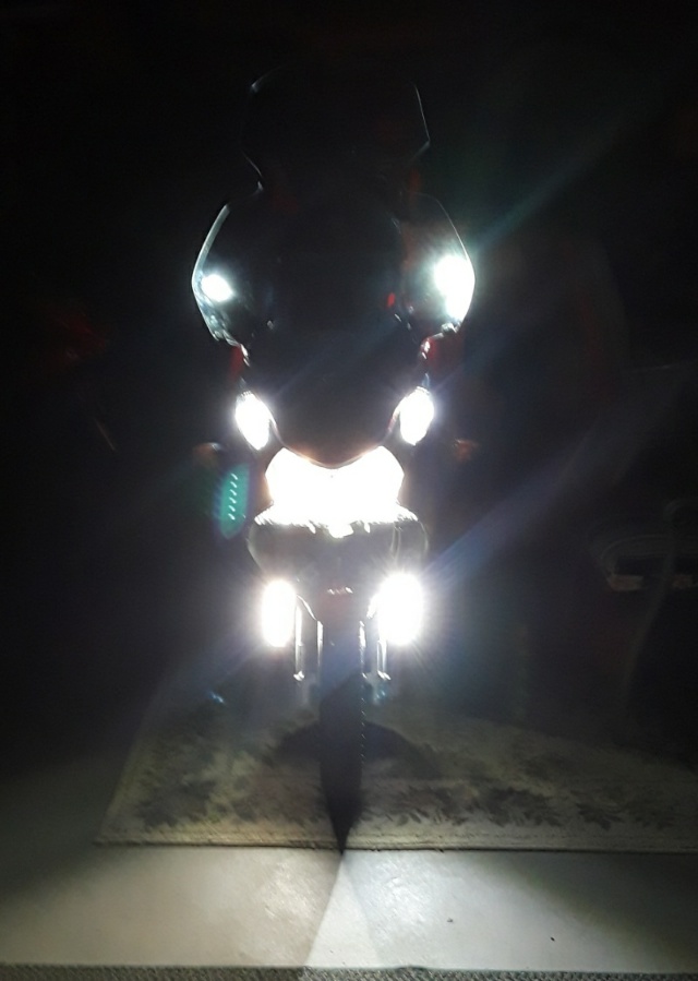

Just to show you what you CAN do with lights:
Front lights now.jpg (104.07 KiB) Viewed 1505 times
New brake lights.jpg (60.58 KiB) Viewed 1505 times
