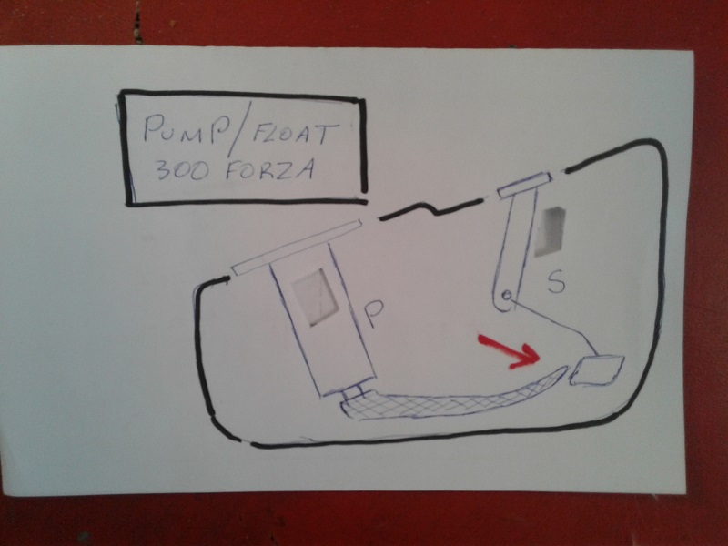

Yes, the fuel pump/ float assy was probably installed incorrectly when recalls were done. The fuel
pump assy could probably be re-positionned properly, though (It's not that complicated to remove
the related plastics and luggage box, I found).
Then that gauge is near useless even when working -- designing an accurate gauge for such a
weird-shaped fuel tank was almost impossible, anyway. Mine is like the other ones : stuck @ F for
100km...then dropping rapidly to E...with 4+ litres left in it !!. After a while, one learns to keep
an eye on the tripmeter, too.
