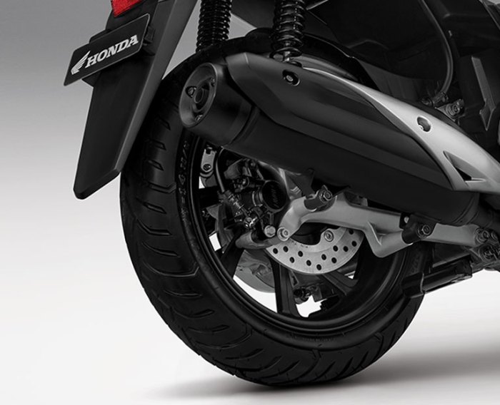

Hi I'm from Taiwan PCX rider
Can I ask a question about is Can 2017 PCX the trailing wheel drum ghost changes 2018 PCX the small dish ghost?

Hi, have you seen or anybody seen a PCX with a rear disc brake or is this picture an artist's impression of a PCX with rear disc brake.

It's not an artist impression, it's for real - but only for 2018 models in Indonesia and few other countries in Asia. ABS available too...

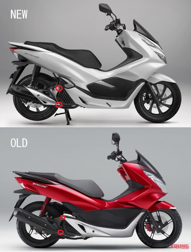

Don't think you will be able to adapt new rear swingarm to a led pcx- even if front anchor points are identical, shock are located differently and more vertically than current model....

Regarding the rear shock, it does not seem to be different orientation to me on the top two side pictures, but I might be wrong. Aso difference of angle could be from changing the to mounting points too, which would be still fine.
A simple retrofit would require the rer wheel with brake disk, rear triangle, rear caliper, hydraulic cabling, rear master cylinder with lever at least.
A full retrofit would need all hydraulic cables, a front and fear abs senders, front abs ring, abs control and wiring plus a lot of elbow grease.
Could i be technically done? Probably yes. Would it be feasible? Most probably no.

It seems to make sense as i don't see any ABS traces on the rear disk (sse the pic above)-
