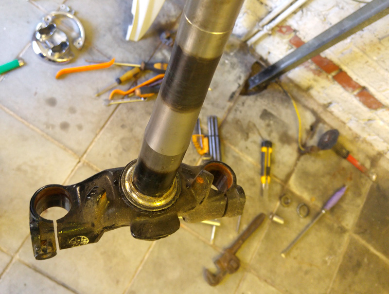

    3) Last and most revealing check: remove front wheel and forks in one piece and the handlebar as well. Grab the steering stem from below and turn it. It should turn as smooth as butter. if it feels stepped, rough, makes grinding noises, it will need your attention.
My steering did not have any play, it was making just a very faint squeal on the left side. I would not actually believed there was anything wrong with it until we did step 2) and there was definitely a hard spot dead center meaning a bearing replacement at minimum. We did bearing and races just to be on the safe side. Personally I thought that I wasn’t that bad, but my mech convinced me to tackle the issue.
It is only when we had dismantled the scooter and incidentally dis as in step 3 that we found out how really bad it was- incredibly stepped all the way. Yet I could not tell anything while riding- you adapt yourself gradually and don’t notice the defects of your bike.

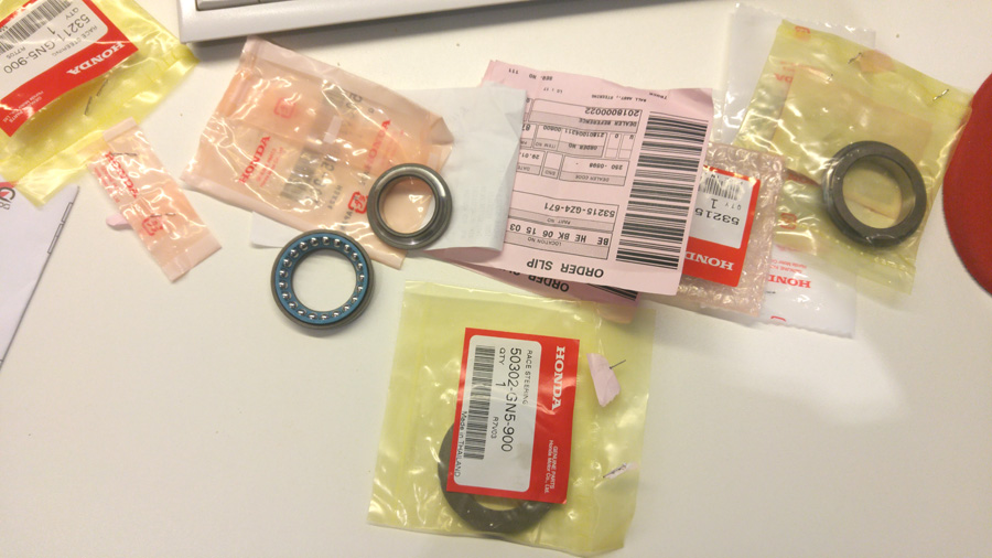

If you’ve got those symptoms, it’s time to grab the parts. You guys in the US don’t know how good you have it, below are 100 eur worth of races and bearings, you’d pay half of that with partzilla…

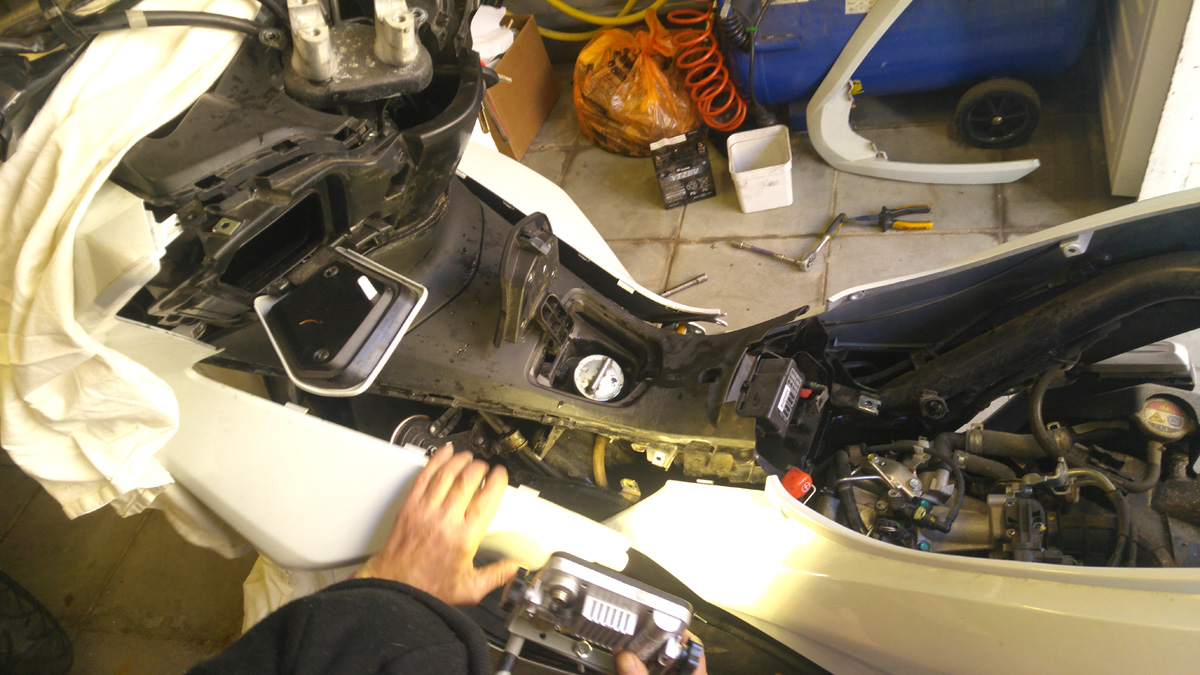

We did sort of Hacker’s way and removed some unnecessary things like the luggage box because that was what was written in the crappy French Workshop manual. We did not remove other stuff which in retrospect i would have. I had bought a subscription to cyclepedia PCX manual but they don’t show panels of the led version even though they claim it’s for 2017 pcx 150 as well? WTF?
- Remove saddle.
- Remove front cover panels ( you could leave them partially attached as we did but I depends how you support your bike): windshield, meter panel front the two side panels
- Remove Inner cover: plastic cover around glove box, then its sister part on the right, then inner cover itself
- Remove handlebar, you can leave it with all attached if you accept that you might need to Bleed the brakes (the two pistons from right lever), the CBS master cylinder will not be affected)
- Now remove post handler under steering stem making sure not to lose the spacers
- Detach brake caliper.
- Secure you scooter and remove front wheel with forks in one go.
Whoah….You haven’t even started yet!

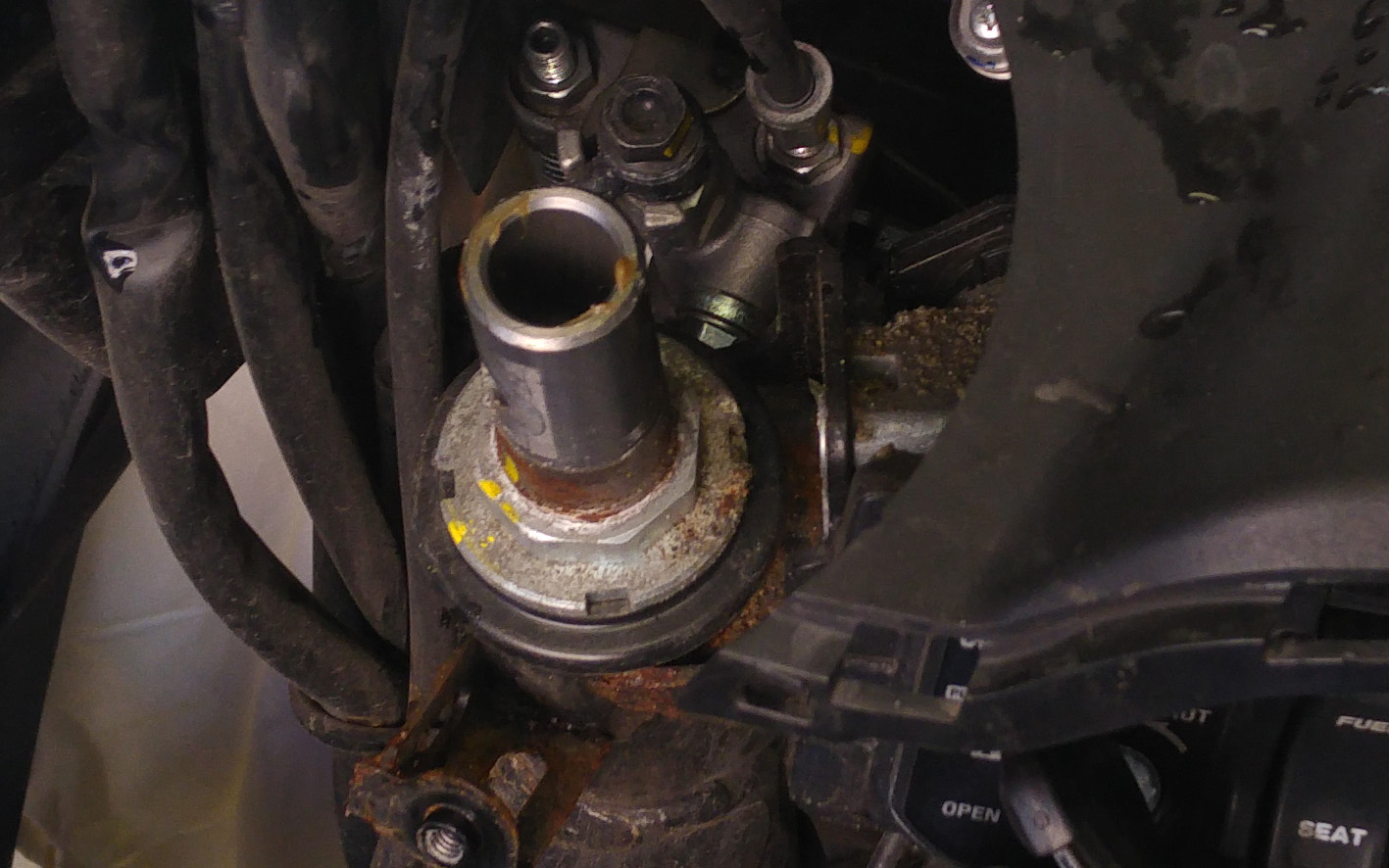

When you reach this stage of the image below you almost ready to begin, just take away the bolt and remove the post.
The petrol lid cable is a real PITA to get off

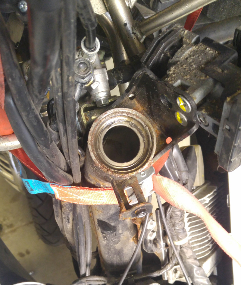

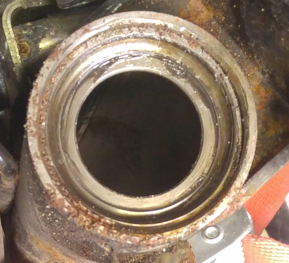

Now the fun begins...
Notice the corrosion? The single most corroded part in my pcx, i've got no rust elsewhere on the frame. who would have thought this?

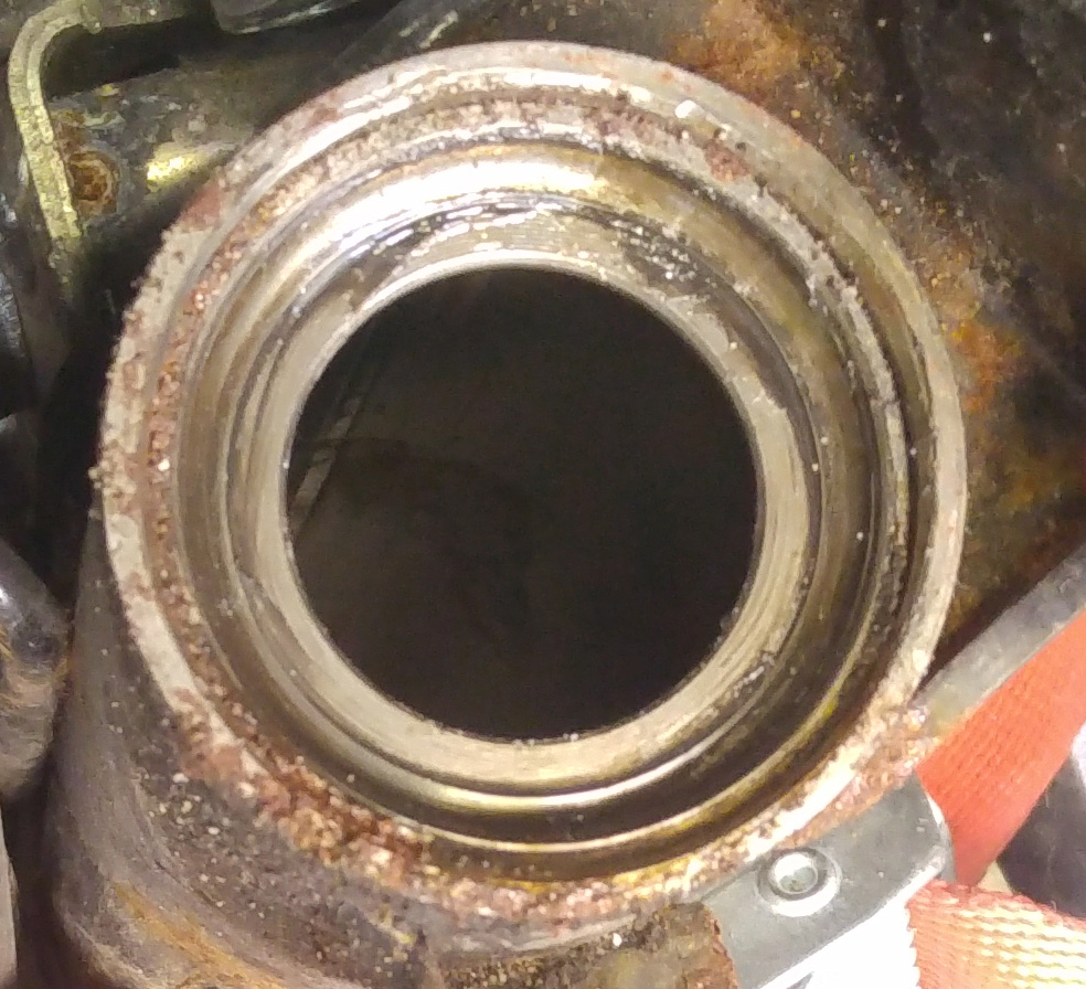

the top race.
top race.jpg (309.95 KiB) Viewed 13841 times
zoomed in: not very pretty.
top race2.jpg (323.89 KiB) Viewed 13841 times

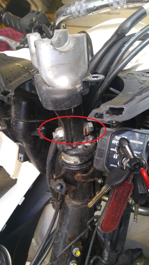

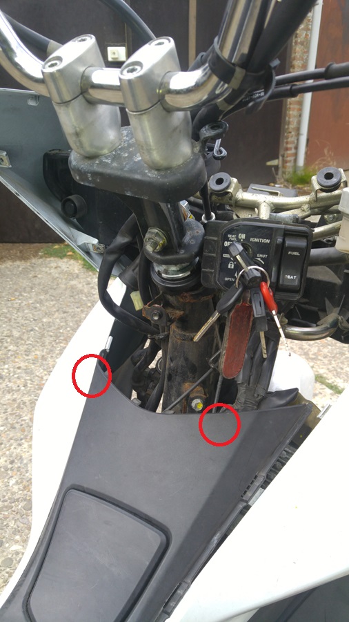

Here: Remove windshield and plastic below it, then remove whole speedo.
remove the little cover just under headlight bu pulling straight towards you and unscrew the two screw of front cover, left and right.
- now you can remove the inner cover panels. Be careful the top half is attached with two screws, you can access those by the front wheel well above front guard see below
Re: Steering stem bearing and races replacement

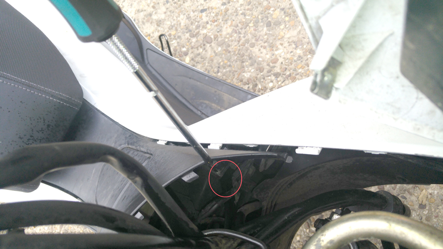

Posted: Mon Jul 09, 2018 5:37 am
by tomtomclub2005
Hidden there: you have to access the screw by below (opposite of screwdriver direction shown)

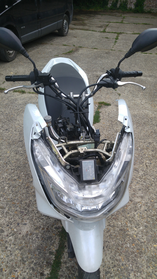

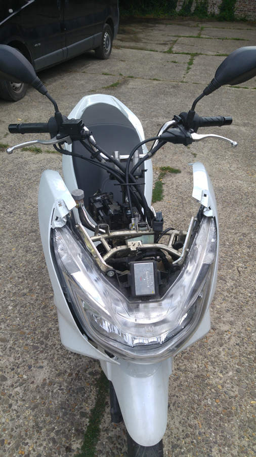

You will reach this
You now have enough clearance to work!
Another view:
