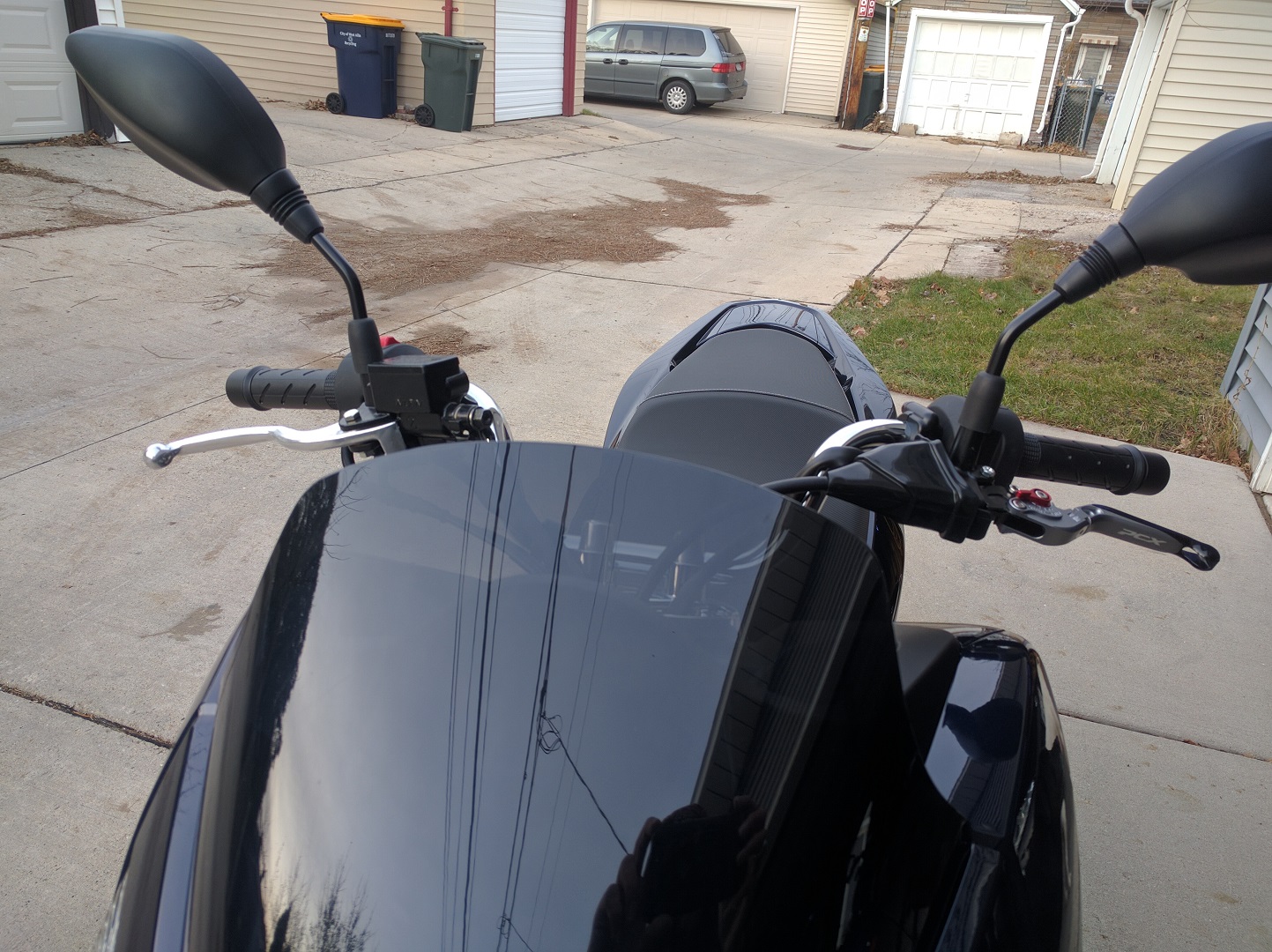

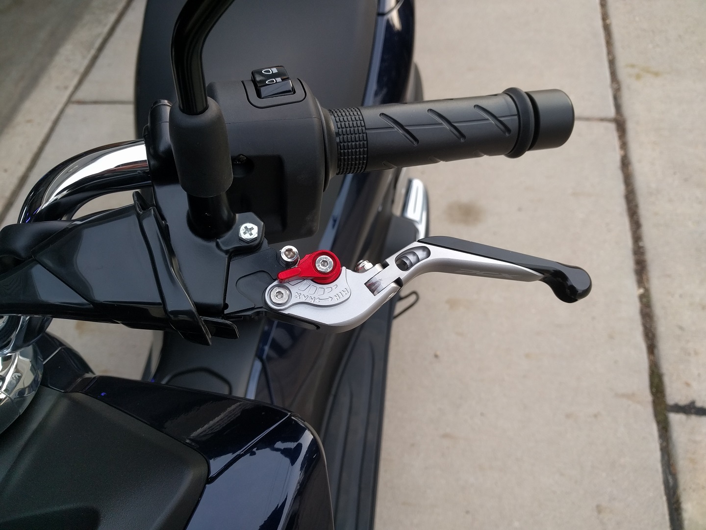

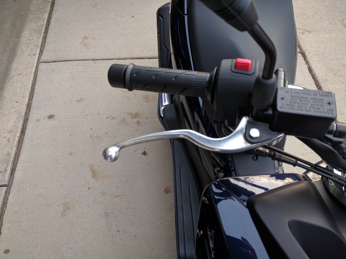

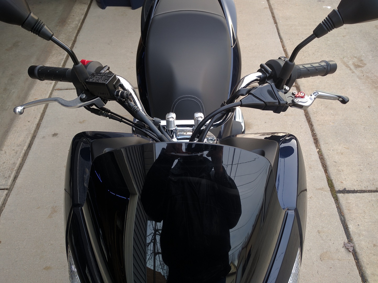

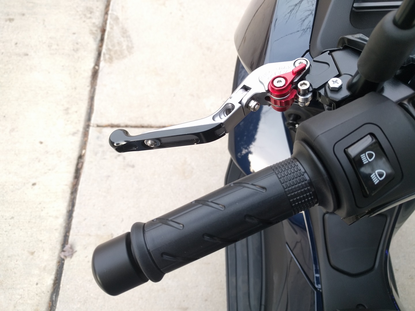

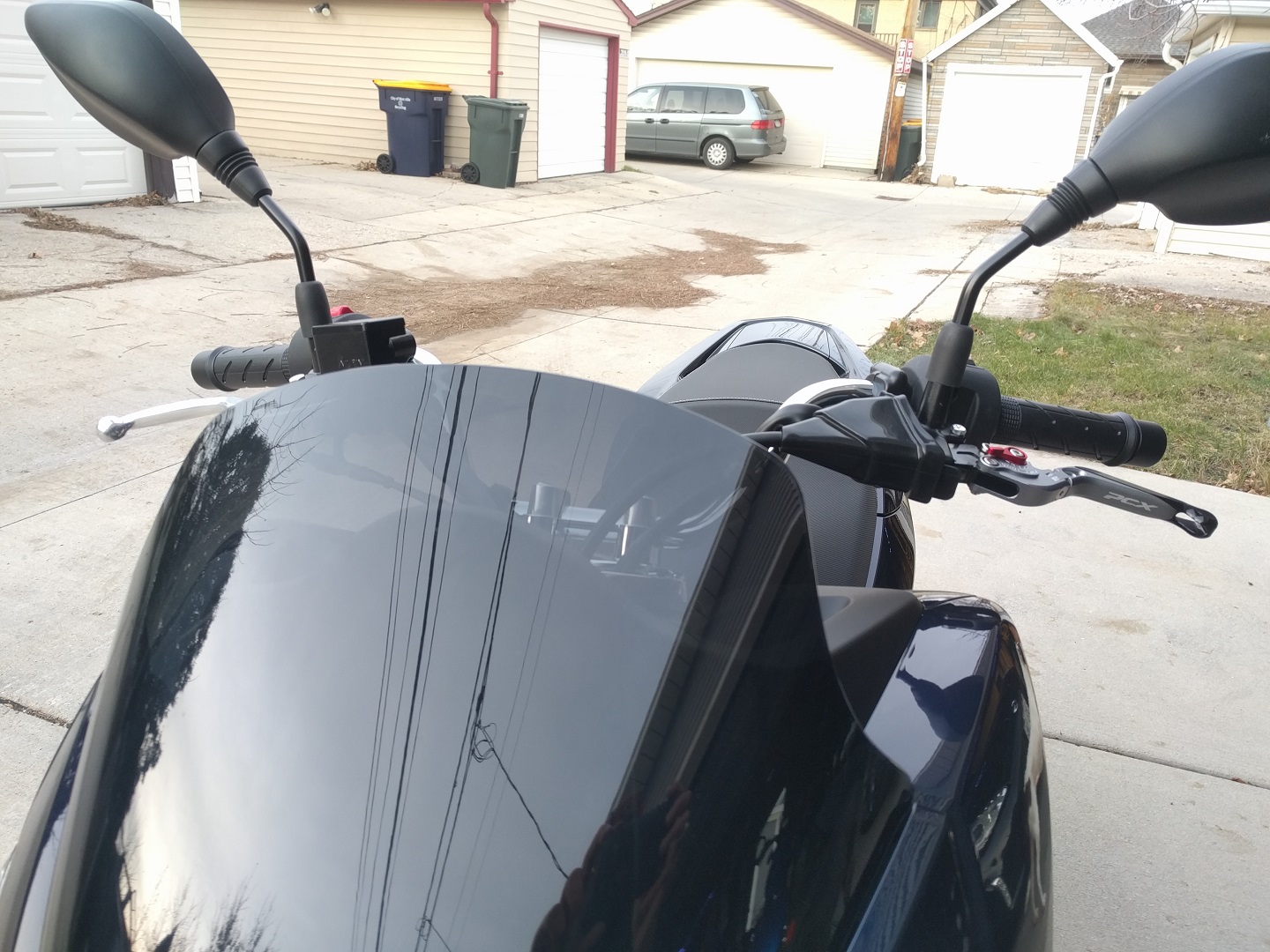

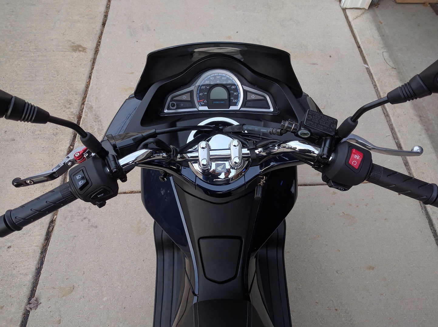

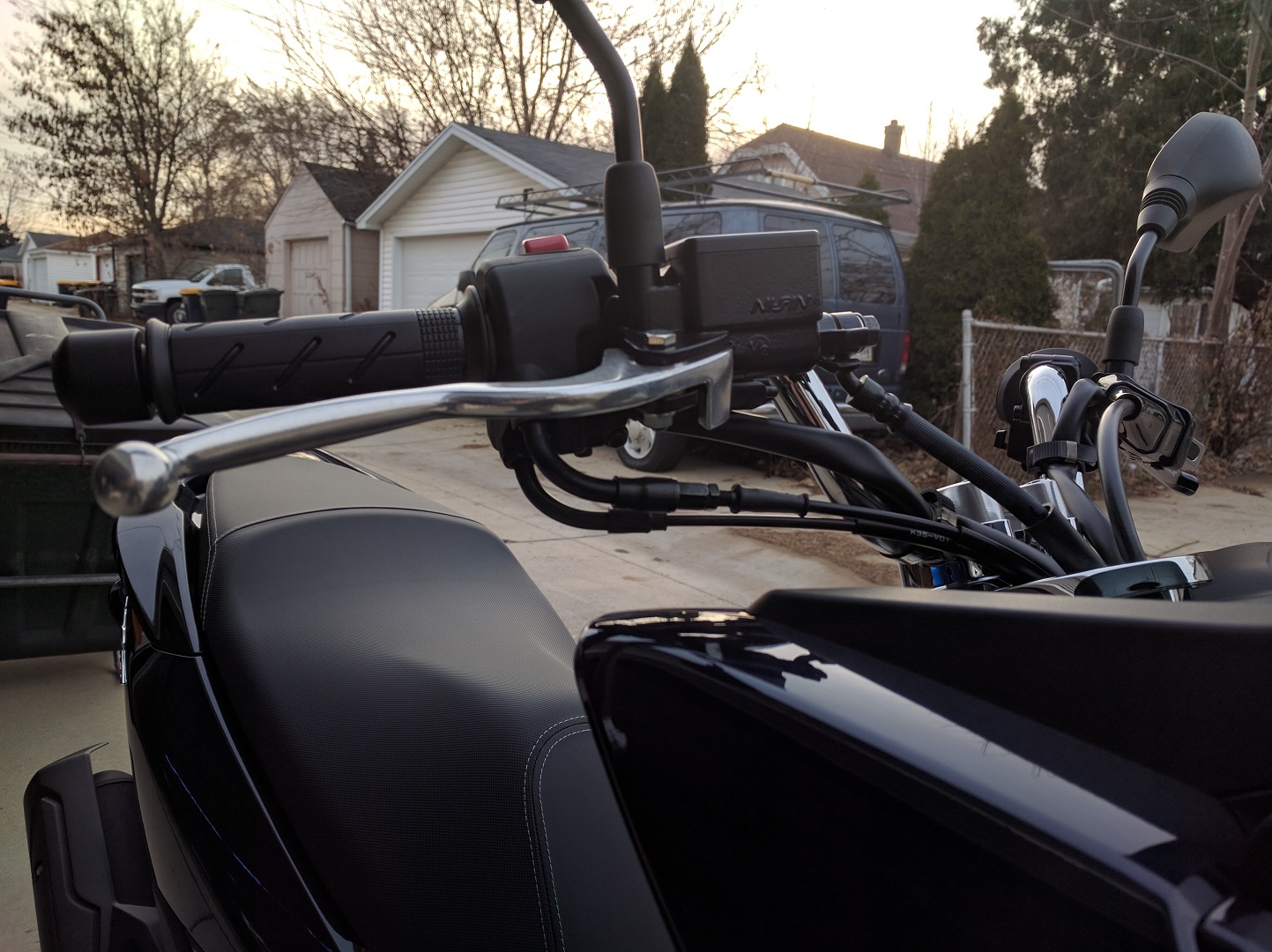

The images have one race lever installed to compare to stock:

11.) The other side (right side) is much the same, but easier. (Your left hand is where the wedding ring or "slave band" goes, you didn't think that would be easy, did you?)
After removing the pivot bolt the lever just pulls out! Instead of pulling a cable the lever pushes against a hydraulic ram, so all should go smoothly.
The reason I mention this side second is because this is the side where the lever slot needed to be opened, and that's a finesse job. Plus it's actually harder to get the lever in and lined up because on the other side the emergency brake holds the cable for you making the pivot bolt easier to line up and slide in, but here the ram will be pushing against the lever making it a bit more frustrating--so this is a finesse job also.
