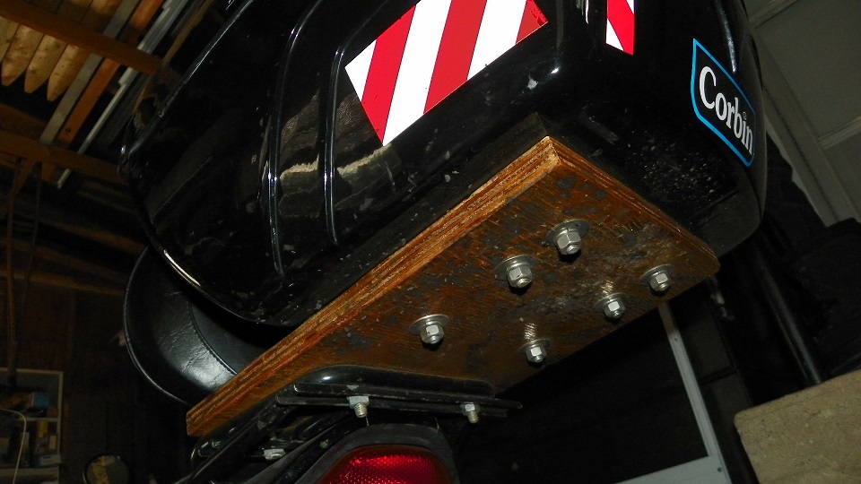

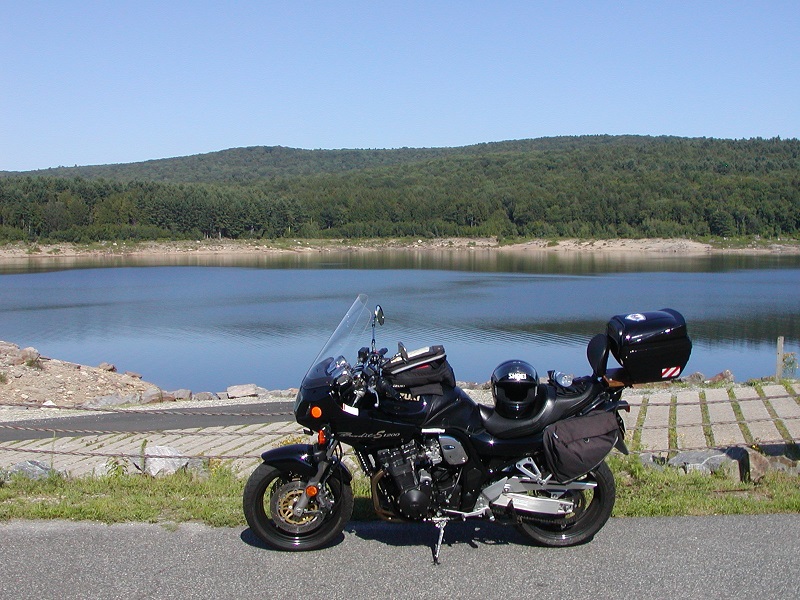

On my Suzuki Bandit I used a piece of pressure treated plywood mounted to my luggage rack to mount my EMGO travel trunk (the older version) on. I also used stainless steel hold downs and big washers. It extends the position of my trunk just enough to be able to use my Corbin seat with the passenger backrest installed. . .so it's all good. Necessity is the prime motivator in times of hardship. . .it really does make one put their thinking cap on.
I do pay attention to how much stuff I put in it so as not to overload the rack itself or cause handling issues.

Precarious! That is the only word I can think of for where that particular "Travel Trunk" is located. You definitely have to watch how much weight you put in the box. All of the stress would be right behind the seat, probably right behind the bolts.

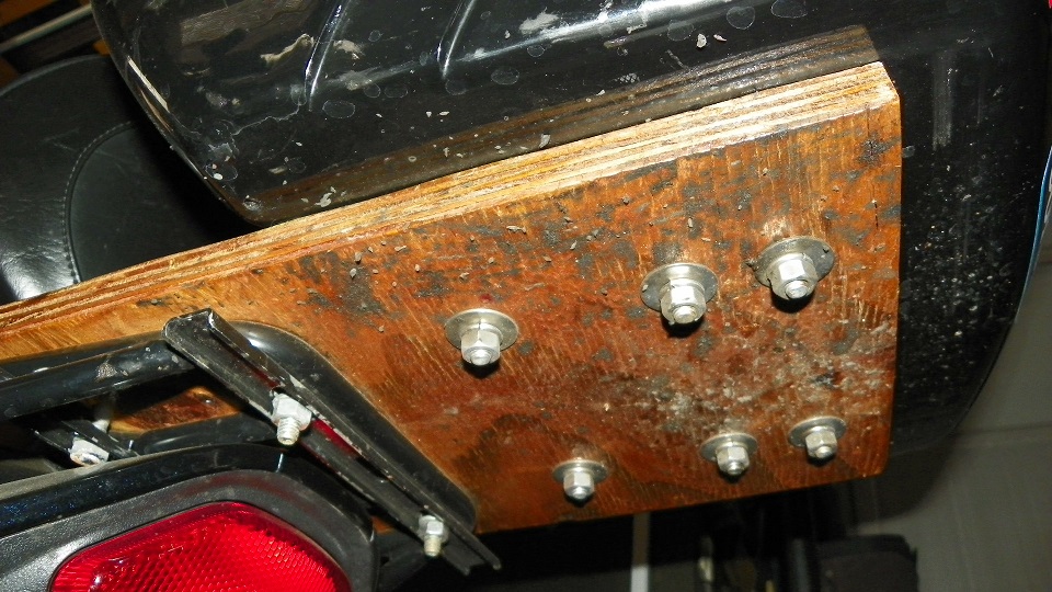

You're right. . .and I did leave a comment under the pic about that on the post.Precarious! That is the only word I can think of for where that particular "Travel Trunk" is located. You definitely have to watch how much weight you put in the box. All of the stress would be right behind the seat, probably right behind the bolts.
I've had the machine since it was new. . .20 years old now. . .and make certain to only put stuff like a helmet, sweatshirts, food (no liquids), or other lightweight crap in it. Heavier stuff gets sorted around between the tank bag or soft luggage. Nice thing about the soft luggage is I can re-purpose it between the scoots too.
The plywood is thick and the bolts are stainless. An added plus to having the trunk is it provides a surface to put additional reflective material on.
If I ever sell the machine I'll take the trunk off and just put it back on my KLR (which is now 30 years old. . .bought that new too!) where it was originally mounted.
Here's some more pics. It's due for a more thorough cleaning but I won't be doing that anytime soon. Temps around 10 degrees today and snowing. Probably won't get above freezing until the second week in January.

Doesn't look precarious to me, at least not from a "snapping off" point of view. I expect that 3/4" plywood would support at least 40 pounds of stuff bouncing around back there. Not that you would want to do that (handling might get funny), but in a pinch I expect it would be OK.
Throwing a leg over - that's another matter entirely.

You mentioned the SS bolts a couple of times. You've got plenty of them, so there's no strength issue here. Just keep in mind that SS bolts (generally) aren't as strong as carbon steel bolts. Of course, in this application the corrosion resistance is more important than the difference in bolt strength.PCX150Rider wrote:... I used a piece of pressure treated plywood mounted to my luggage rack to mount my EMGO travel trunk (the older version) on. I also used stainless steel hold downs and big washers. ...
Also, you might want to remove your lock washers and use Loctite instead. Keep the flat washers, but the helical/split-ring washers can actually accelerate loosening!
