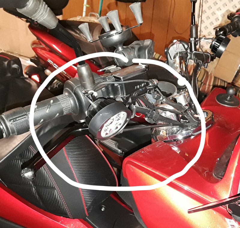

Posted: Tue Jan 02, 2018 11:17 am
I just installed some additional lights on my PCX in which I ran the wires down the collar. The only panel I pulled was the one that has the gas cap door. It was an easy mod. You should be able to do the same thing on your bike.
