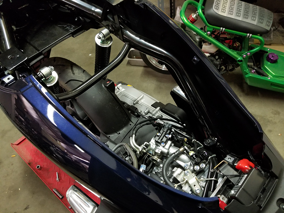

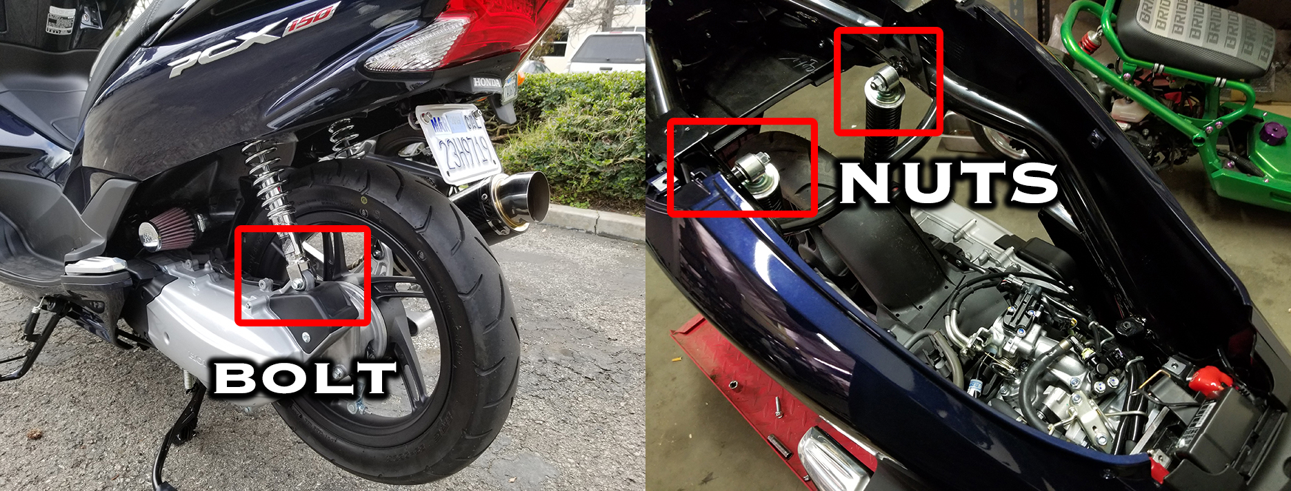

Its pretty straight forward. Remove the storage bin and seat. Once you remove that its just 2 bolts per shock. I can take some pictures of the what bolts and retainer pins you need to remove in order to remove the storage bin if you'd like. Its rather easy, I do it all the time.

you you wrote:
Is it two bolts per shock? The uppers look like nuts with integrated washers.
Each shock has:
- 1 nut on top
- 1 bolt on the bottom
