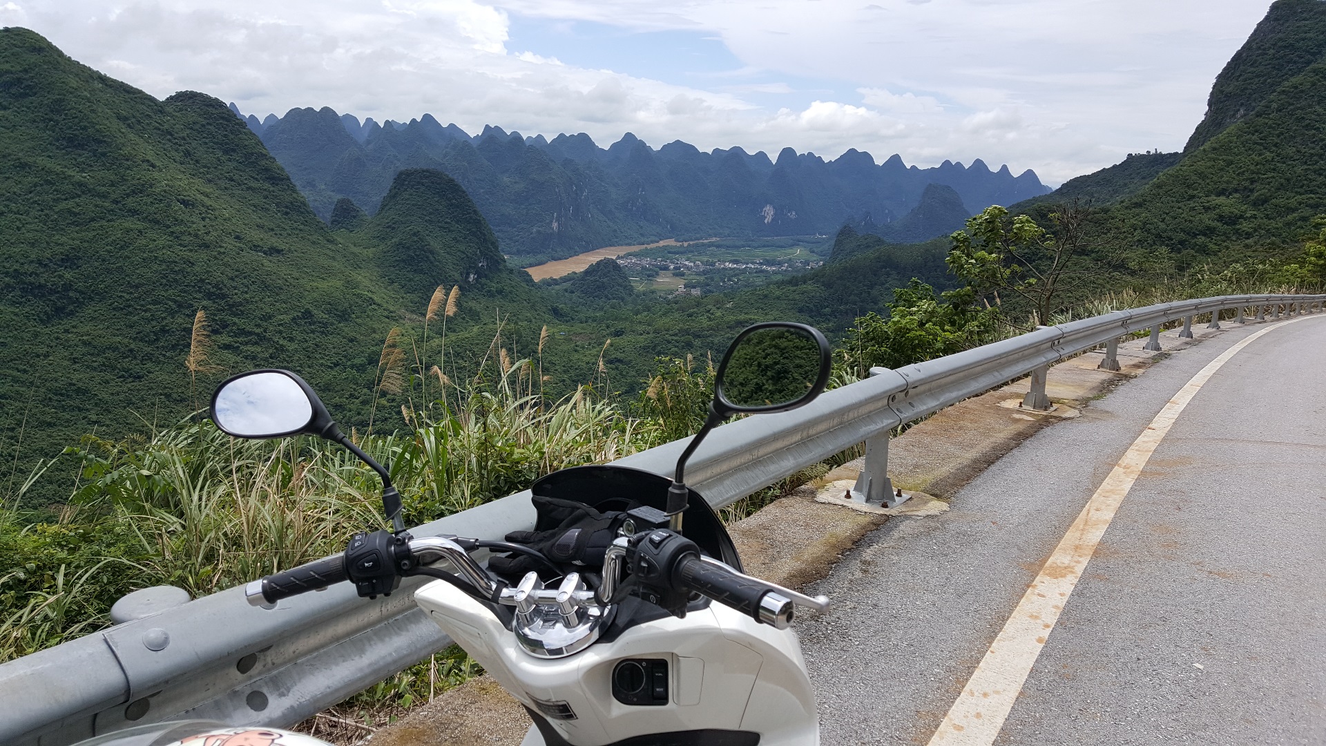

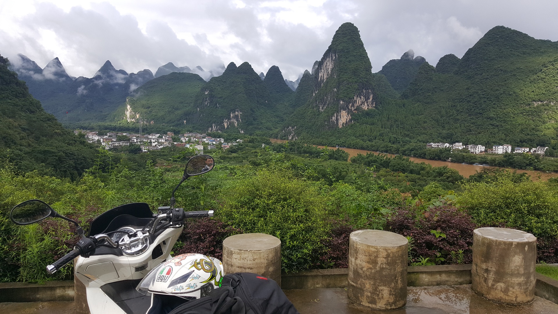

Well, (check me on this) my calculation says that's about 10% of the normal capacity down in 2,500km / 1,550 miles. You're riding long daily distances, and the average temp is about 32c / 90f and you're using 0-40wt oil. Based on the photos (beautiful countryside !), is it correct that a good part of that riding has been WOT or nearly wide open throttle going up significant hills?
If so, that combination of factors might result in more oil usage than a typical "around town" usage .... but I'm not sure if other PCX owners have experienced similar usage on extended hilly trips.
