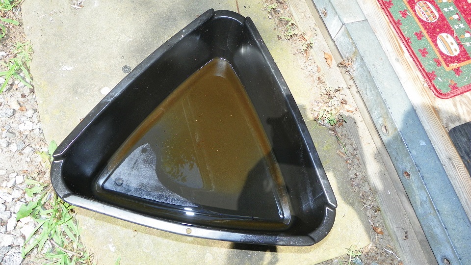

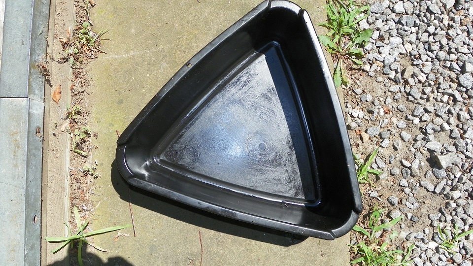

Below I'm providing some pictures do show the condition of this oil since it was the first change on the final drive. As an added note I had previously done the engine oil at around 600 miles and used the same type oil except in a 10w-40 weight.
Drain pan was clean without any grit or particles before oil change.

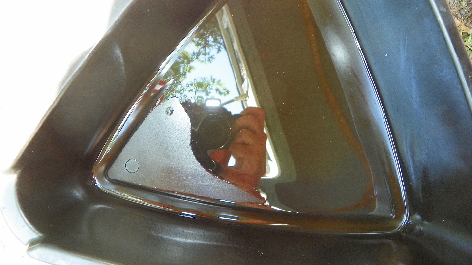

Oil was drained and there were some trace amounts of shiny particles in the oil. . .sort of a goldish color. . .break in debris I guess.
Another closer pic of the particles. Will see how it looks the next time but I think after 1000 miles it should be pretty well broken in by now and the next time it's drained hopefully it will have little or no grit.
